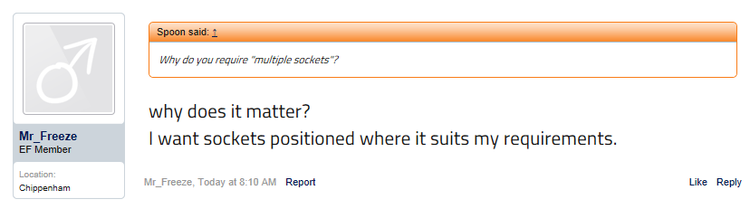

There is nothing wrong with this as the feed in to the garage is fused at 13A already.
2 RCDs in series makes it very hard for you to test the RCD tripping times when you carry out the essential tests before putting your new work in to use.
The additional MCBs won’t make any improvement as the current protection is correct, however they will have no practical negative effect on the installation.
Yes the armour should be earthed at least at one end, preferably the supply end.
No DP isolation is not normally required.

I have no problem with answers about regs and I don't believe any disagreed with what I asked or planned other than they frowned on the doubling up of the RCD protection.
Asking questions like why and how many sockets do you need isn't helpful.
Stating the obvious like you will only have 13amp supply isn't helpful, all were stated in my original question.
I came on asking questions to get help and got bombarded with people wanting to score points off me with sarcastic replies.
I've come over as a ----- because I cant stand people trying to score points off of me on what is supposed to be a help page. I'm not a ----- but I don't responded well to ---- takers.
