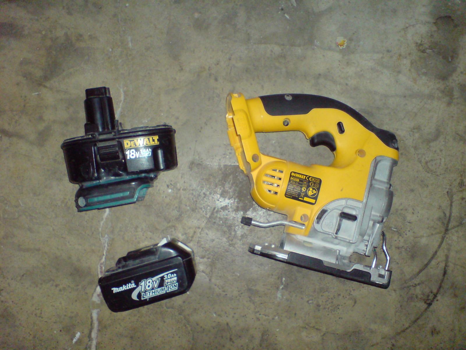

It can be done. See pictures.

Where's your modding sensibilities, guys?! I want to know how that works...... I have plenty of knackered tools with great batteries, and good tools with knackered batteries, getting them to fit this way would be tidy. Also, would be cool to get three or four lithiums that fit all your tools with various 'adaptors' for all your tools.
Is that just the shell of the dewalt battery, wired to the makita clip diretly so it fits, then? I like it!
Yes, it is. All that you need is a knackered battery holder and an empty shell. Then you cut it, clean it with sand paper and then glue it with solvent cement. Make sure that the positive and negative are correct in case you want to use the Dewalt charger as well.

you should make a video of how its done.
Well, my Makita SDS packed up after 2 years of heavy duty use so I was left with two healthy batteries that I wanted to put into good use.
Currently I haven’t got a body and faulty battery to use in order to create a clip.
tell you what the drills are bulky enough sometimes never mind extra bits hanging off them in a cupboard, think i will stick to the standard batts.
phil does have a point, wonder if theres a way of slimming it down? still a good solutIon though.
maybe an umbilical cord type thing like you can do to the makita batts so they clip onto the belt rather than the drill. makes it real light and easier to work with
I thought about it though. It is like the power supply to the cameras flash in the past with a flex curly wire.
