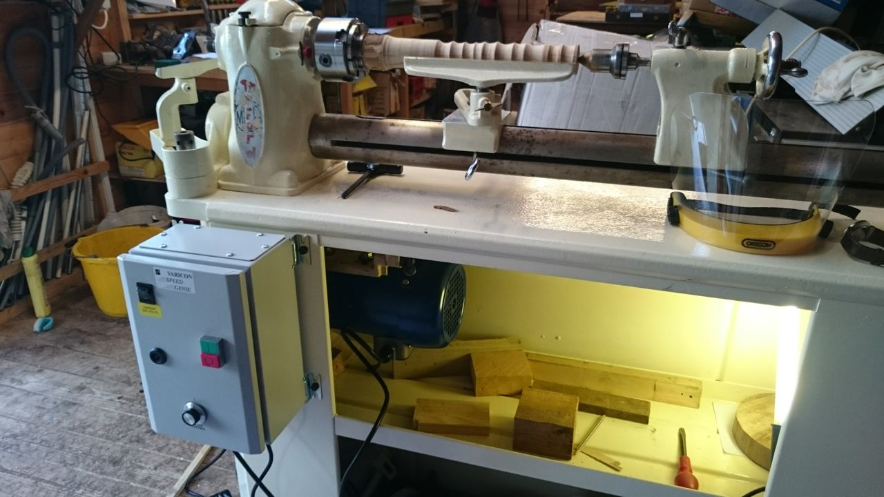

Thought I'd follow this up with an update...

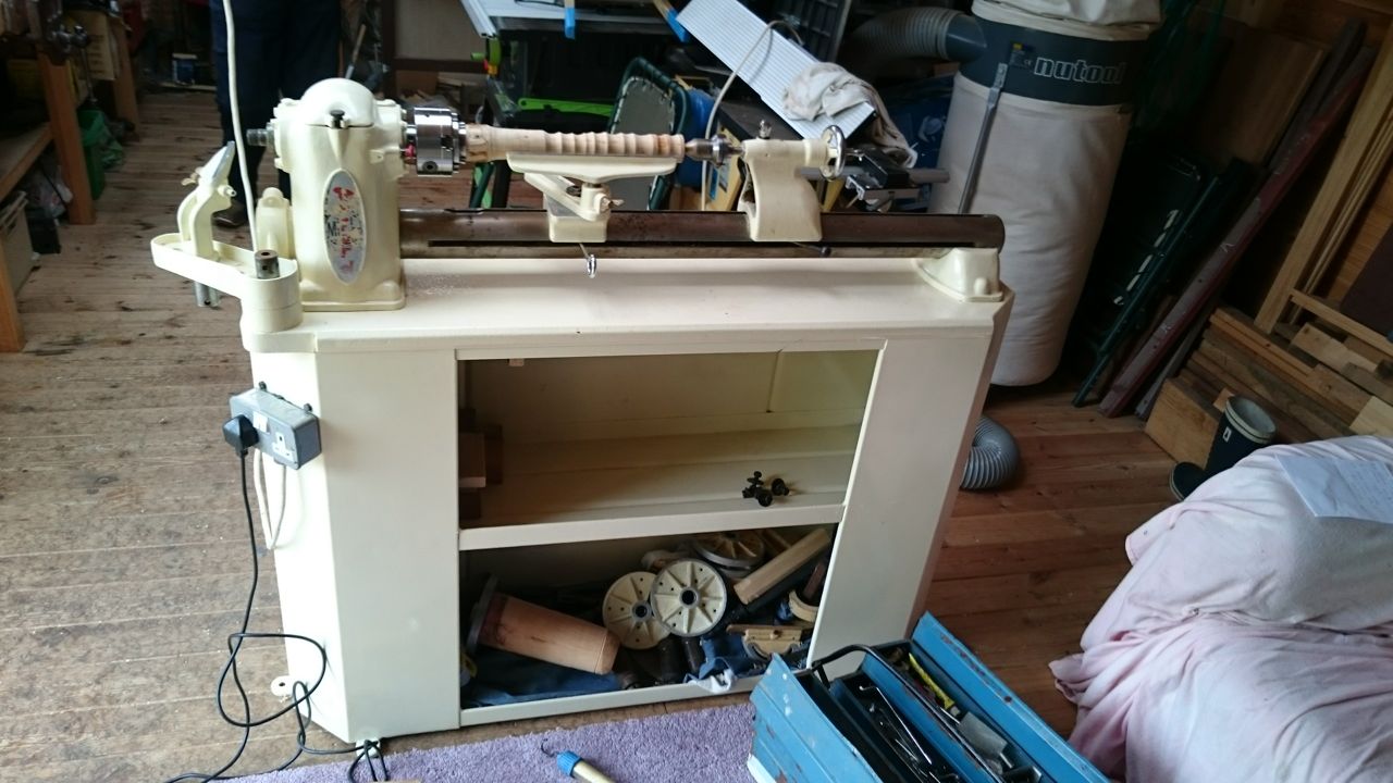

So we arrived in Norfolk end of last week, and I had a look at this lathe. It's a thing of beauty.
[ElectriciansForums.net] VFD for old Myford ML8 wood lathe (0.5HP, single phase)

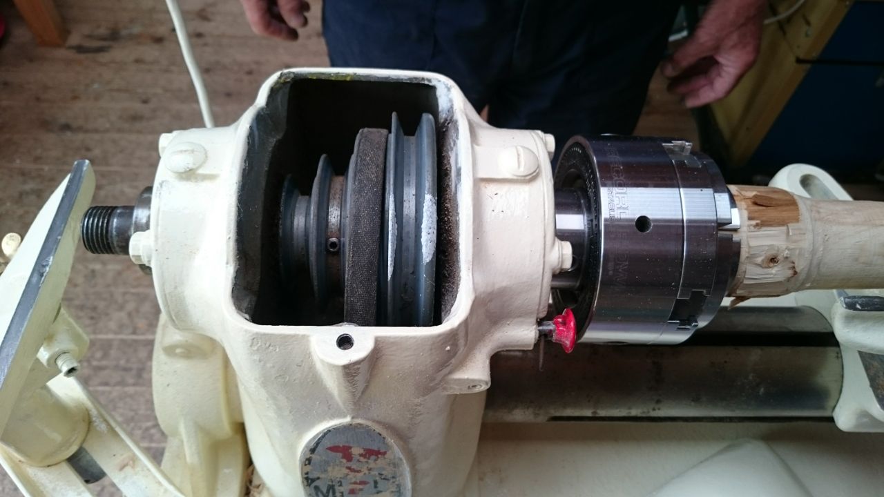

The motor is mounted underneath in the (mild steel) cabinet, with the pulleys on top transferring the power from the motor to the main spindle. (Dad's already bought a new chuck for it.)
To change the speed, you release a bolt on the motor foot mount, hinge it up, tighten the bolt, and hope it doesn't slip as you move the belt over.
The motor just had a plug top on it, and was started and stopped by (I kid you not) turning the 13A socket-outlet switch on and off. So far, so scary.

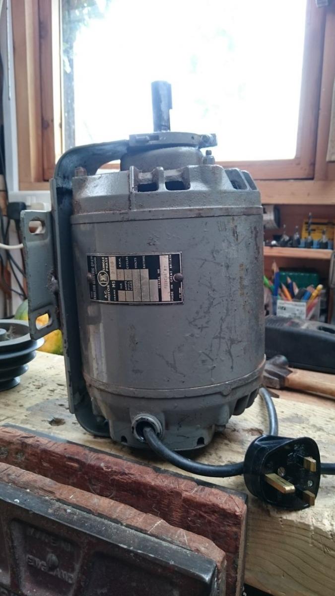

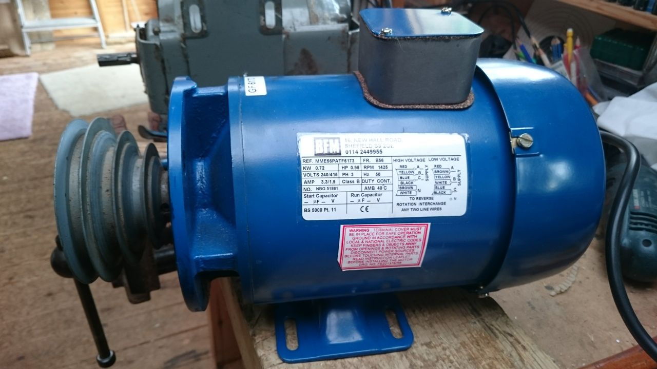

I've learnt an awful lot these past few days, mostly about motor frame sizes. It seems there are essentially two standards - imperial (NEMA) and metric (European, IEC). (Forgive me if I've not quite got the terms right). Needless to say, this old thing is pre-metric, and most UK motor suppliers seem to sell metric. New holes in the mounting plate wouldn't be too much problem, but the 19mm shaft diameter (rather than 5/8") would require a bit of engineering and/or new pulleys and belt. This was starting to look like a bit more work than I had hoped, but not exactly wanting to leave this in the state it's in, my dad and I came to an agreement that he would buy a third party conversion kit, so at the very least it will have an e-stop, DOL starter and no need to risk trapping your fingers as you move the belt over the pulleys.
So we've ordered one from these guys: http://www.haydockconverters.co.uk/lathe_conversion_kits.htm
We've taken off the old single phase motor in preparation, which I get to keep and poke about with by way of thanks:
If it arrives this week I will help him fit it.

Thanks for the update.. and you just had a little taste of my world :)
PS - I'll be interested to know if that wire feeding the motor from their site pics is screened?.... if not it won't meet EU directives.
Just out of interest, if the lathe is for owner use only and it's kept in a secure location do all the machine regs still apply? I know where I am the electrical installation regs would apply but not the machine regs.
The speed changing system you describe Steve was very common on basic machinery that didn't need frequent speed adjustment. The more upmarket machines came with semi-automated pulley called a slip pulley as described here that changed it's diameter as its width was changed and it gave a wide range of speeds.
