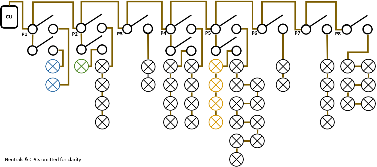

Hoping to get opinions on Vd calculations for a 1.5mm2 downstairs lighting circuit with an estimated length of 128m!
Length is due to loops at switches (neutrals required) and switched lives feeding various strings of lights.

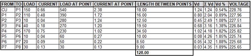

Calculate Vd between each point and derive the sum. Example.

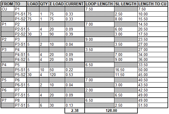

Loads have been totalled with loops and corresponding switched lives treated as one length between each point.
The current is adjusted to account for the voltage drop at each point. The result is a small increase from 2.35A to 2.38A.
From the table below, Vd comes out at 4.35V (1.89%).
OSG Table 7.1(i) suggests a max length of 106m for a 1.5mm2 lighting circuit with a 6A Type B CB on a TN-S supply with 30ma RCD.
The question, Is 128m acceptable provided both EFLI & Voltage drop are within max Zs/3%?
For completeness the max Zs is 5.83Ω and calculated Zs at 2.67Ω. See table below:

Why don't u included cable between switch to lighting?
R2 tested at each light to confirm earth continuity
VD at furthest point or points where load is max
Zs we know for certain is from the furthest point, in this case 51.50m.
Are you suggesting Vd should be also be based on this length?
I was led to believe that Vd should account for the entire circuit length.
I haven't sat and calculated it but your Method 3 would be perfectly acceptable.
As for Zs if you have RCD protection then that can provide fault protection.
VD would have to be calculated incrementally, at each point where a lamp array branches off from the feed to the last lamp, for the calculated load at that point.
Would be easier to measure VD at the furthest lamp, instead of calculating it, since that's what actually matters. Measure the voltage between cpc and live and cpc and neutral and add them together.
