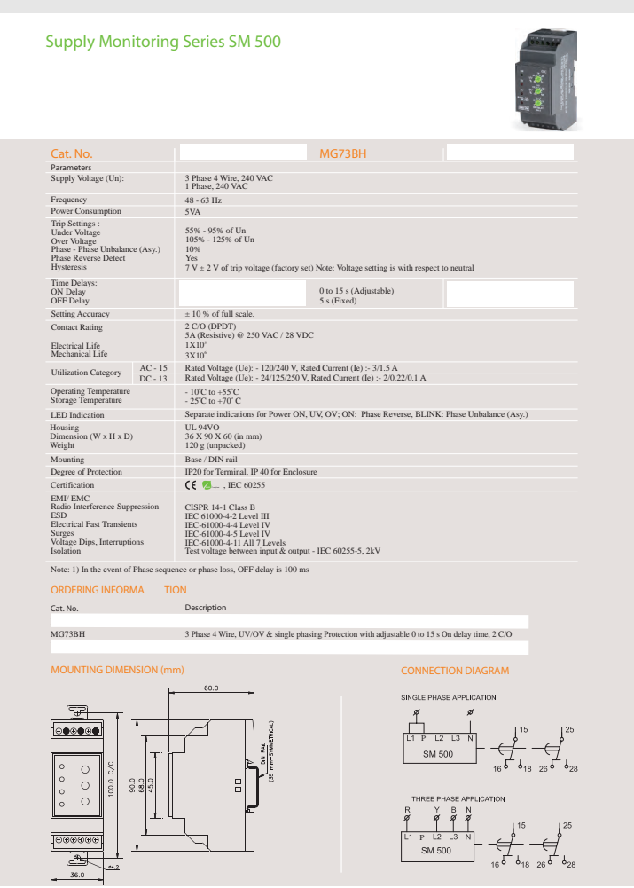

I see this model the on-delay is adjustable which is useful to prevent the supply bouncing
Is the 5s fixed delay-off time sufficient to prevent equipment damage , in general ?
