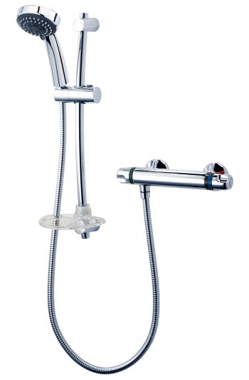

2) So what would a "normal" shower look like ? something like this?

@ KevinS - OK that's certainly an option for me. Aspirante Thermostatic Power Shower - Chrome somethign like that? If I wanted to relocate it 2-3 metres in the same room though, how much work as a sparky do you think that would take?
The supply for the pump doesn't have to be a new circuit, it can be spurred off an existing circuit. The plumbing side of it isn't necessarily that difficult either with connections generally being with push fit connectors.
Right so the sparky work required to provision a pump is less than it is for an electric shower due to the electric shower needing a new 10mm cable ran from the fusebox. Got you.
Is the one I linked the right type I should be going for? Mixer Showers, Shower Enclosures, Bathroom Supplies
