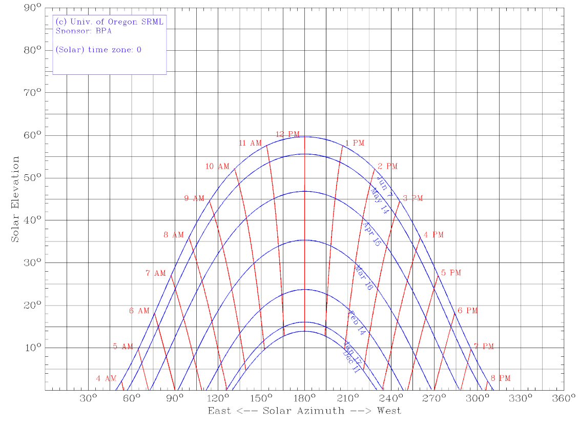

In Essex east/west split 3.84. KWp 22.5 degree. 4.25kWh a day.
Edit 4.5kWh today
Here's my calculated Azimuth;
