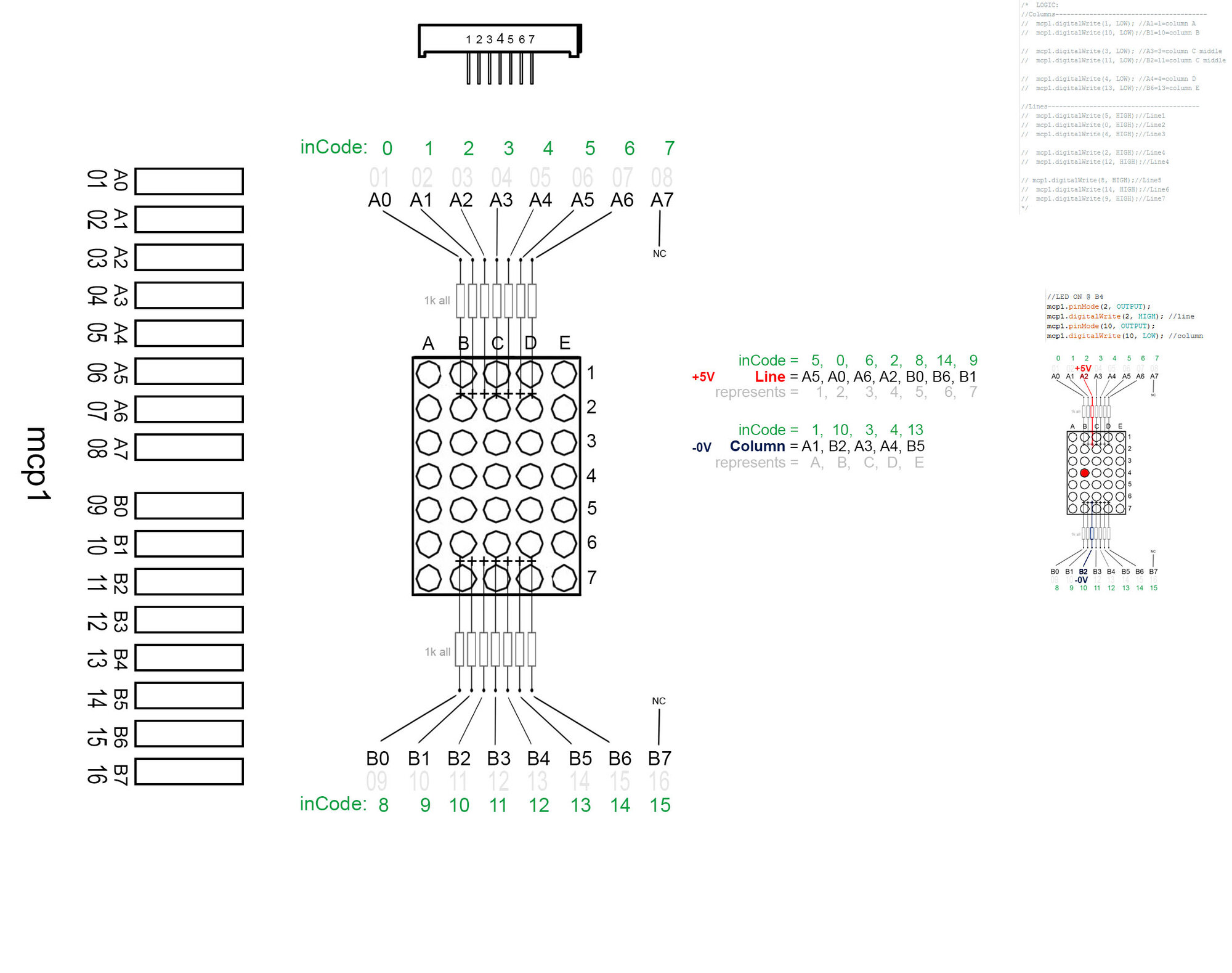

Hello mister @marconi
I finally used your led matrix. Not as we originally intended but with interesting results.
I may say, it is a bit dificult component because it has some specific pins for positive and negative connections Aaaand it also has a inverted way of connecting as well. Interesting functionality but hard to pinpoint. It was hard for me because it is my first time with such a thing. The conclusion, it was a success and I am happy with the results. Even if it is a test or a game.
Here is a slight longer movie that I originally intended, with many-many points in it.
Thank you for watching and I will make those letters as we discussed in the beginning when you send me that led matrix.
See what happens to the circling led display as you speed up the scan rate. Does this give you a hint on how to use this display?
ps: I am pretty sure I sent you the data sheet for the 7 x 5 matrix. If I remember the LEDs are wired common cathode but do check this - in groups of 5 LEDs, one group to each of the 7 lines.
Oh, this is not new to me at all. I am very aware of cycling rapid times gives you the desired shape or character on the matrix. I know this from when I was 7 or 8 years old. Really, I read some interesting stuff at that age, but... you know, capitalism is keeping me down.
And yes you send me its datasheet, and I did use it but is having some weird circuit schematic inside that I could not use it in practice so I had to re-discover it by trial and error. Eventually this is the secondary role of a bad diagram in a datasheet, to put you to test the thing and figure it out by yourself. Its not the first time and not the last time I get it like this.

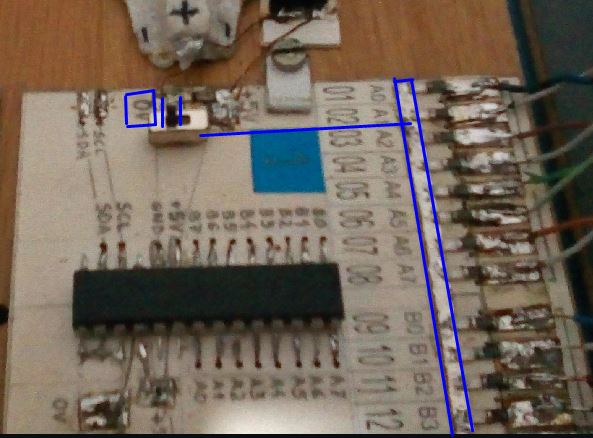

I was unsure and I re-check it with the datasheet of the MCP23017. I got this from it:
High-Speed I2C Interface (MCP23017):
  • 100 kHz
  • 400 kHz
  • 1.7 MHz
I can see diferent values there and they have some specificity I dont know yet. All I know is that this MCP chip, driven from I2C, is doing it at 100kHz.
My math... correct it if you see something wrong, im in the art department:
100 kHz = 100000 cycle/second >> 1cycle is at an interval of 100ms ? Is this right?
Also, this MCP chip has another way of connection:
High-Speed SPI Interface (MCP23S17): - 10 MHz (maximum)
Which I have no idea how I may link it...
The problem is that all the wiring on the boards so far is done for I2C communication ! Not for SPI.

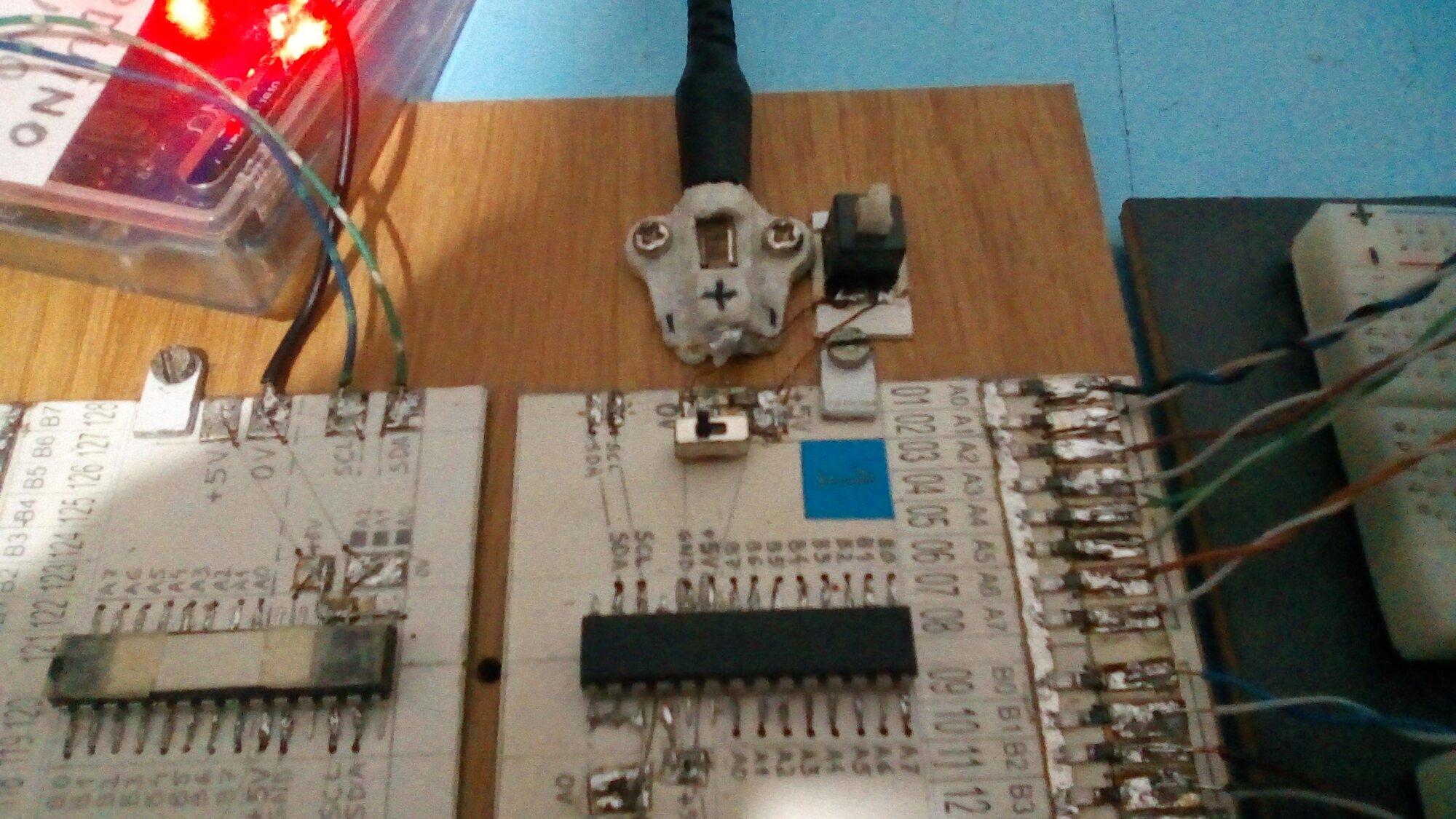

- I start to contemplate the idea of using some faster IC's, like 74HC165 shift registers that @timhoward mentioned already, and most probably more hard to wire in hardware and also much harder to code. Just to have a secondary board. But not 100 I/O pads, just a few, maybe 20 or something. I also remember Teensy board had 40 IO's already and the best one with 58 IO's , which is VERY appealing and also using I2C protocol. Mister @timhoward can confirm it, if is still around.
- Is so disappointing that my Arduino Uno can Not go down under 1ms !!! Ahhhh what a stick in the hearth.
- Also yesterday I received my Arduino Nano board, the replacement for Arduino Uno, and the upgrade for this MCP board I built. I will show some pictures and movie later after I mount everything.

Hmmm.... hehe, here is a quick and dirty way of obtaining 1 single led on the matrix, following my already made example.
Just put 5V on pin 3 (with gray) - also dont forget to put resistors !!!! because you will burn the led !!!
and put 0V/ground on pin 11(with gray). Ive also marked with 3red arrows the positions where to put the voltages on which pins.

So do you select in software one LED at a time by setting one of the line bits and one of the column bits? And then send this data to the MCP23017? Thus to illuminate say all 35 LEDs you have to sequence through 35 pairs of line and column bits (Column, Line). Each data transfer to the MCP23017 has a cycle time Tc - I have yet to find out what this time is. Thus to refresh completely the 35 LEDs will take a time of 35 x Tc - this is the time necessary to send 35 pairs of (Line, Column) messages. This is a slow way to control the 7 x5 display. You could use the 16 bits data outputs in the format ( C1, C2, C3, C4, C5, X, X, X, L1, L2, L3, L4, L5, L6, L7, X) to illuminate a combination of 7 LEDs in one column using one data transfer, and thus the whole display in 5 data transfers - a considerable reduction in data transfer time from 35 Tc to 5 Tc. (The X means not used).
To do this you would have to add some simple hardware to the 7 x 5 display - some transistors and resistors to interpret the 16 bit data word into switches to control the application of 5V and 0V to the LED array. The scanning has to be done column by column to take advantage of the common cathode arrangement inside the array.
Multiplexing in that way is definitely the best way to do it I would say.
Exactly.

Remember a line is HIGH because is +5V and a column is LOW because is 0V. So we lit a single line putting +5V on line01(for ex) and 0v on each desired column.

You basically have to link 7 positive (+5V) pins that will represent your lines and 5 negative (0V) pins that will represent your columns. All passing through transistors (whatever they are, doesn't matter) to be able to command each pin separately from your future hardware code.
You know what is interesting and relatively fast? to put buttons and press them all at once to get ...well, only 1 line at a time. pretty much like I did in my code at very low fv. Or simple mechanical switches !!! So --12-- in total.
You have it. The column Cn and line Ln (my row Rn) bits in the 16 bit data word at the output of the MCP2017 select the column and line transistor switches as on or off. This is done column by column as you see in my earlier video with all Ln set to logic O so all 7 LEDs in a column light up as a test.

//LED MATRIX DISPLAY - Single LED - one by one
/*  LOGIC:
//Columns----------------------------------------
//  mcp1.digitalWrite(1, LOW); //A1=1=column A
//  mcp1.digitalWrite(10, LOW);//B1=10=column B
//  mcp1.digitalWrite(3, LOW); //A3=3=column C middle
//  mcp1.digitalWrite(11, LOW);//B2=11=column C middle
//  mcp1.digitalWrite(4, LOW); //A4=4=column D
//  mcp1.digitalWrite(13, LOW);//B6=13=column E
//Lines----------------------------------------
//  mcp1.digitalWrite(5, HIGH);//Line1
//  mcp1.digitalWrite(0, HIGH);//Line2
//  mcp1.digitalWrite(6, HIGH);//Line3
//  mcp1.digitalWrite(2, HIGH);//Line4
//  mcp1.digitalWrite(12, HIGH);//Line4
// mcp1.digitalWrite(8, HIGH);//Line5
//  mcp1.digitalWrite(14, HIGH);//Line6
//  mcp1.digitalWrite(9, HIGH);//Line7

I counted 7 one millisecond delays, one after the other in this sub-routine. I suppose for now that from the start to end of this sub-routine takes of the order 7mS. I cannot quickly work out if 7mS is to generate a single column of 7 LEDs, a single line of 5 LEDs or all 35 LEDs. Please check my analysis because I am pretty sure I have not completely understood your code. You understand how you have written the code so ought to be able to arrive at figure of about 30Hz or lower which you mentioned earlier.
If 7mS is for all 35 LEDs then the refresh rate is 1/0.007 = 140Hz.
If 7mS is for a column of 7 LEDs, and there are 5 columns the refresh rate is 140/5 = 28Hz.
If 7mS is for a line of 5 LEDs and their are 7 lines the refresh rate is 140/7 = 20Hz
Why do have delay command at all in this sub routine?

Good morning mister @marconi ,
Here is something interesting... Im not sure how much may have been influenced my program testing so far, I will have to make a more extensive research on this particular detail, but in time. For the momment, with the programs I run already, I didnt really observed much of a difference to be honest. But it crossed my mind that this little bugger might be important in some special cases, special programs. Time will tell.
So here it is - full view:
The blue lines represent the Ground or 0V. I marked with a square the 0V marking next to the metalic pad from which the wire is going beneath the cardboard to that long track on which, each negative pin for all the LEDs are connected. So what I have there is a pull down connection through each 12k resistor put in series to each LED to ground.
This problem I realize it yesterday, when I was programming and was meditating to the fact those pins from the IC are not really floating or inAir. I then realized they are actually pulled to ground through each led. And today, I mounted that little switch only between this rail for all the leds and 0V. I tested a couple of normal programs but no visible difference. Ill have to test some in depth programs that I have 'somewhere' that really needs some floating pins. I really hope it will be a difference this time. If not, then, daaaaeeem.
I do not immediately see the connection between the potential of the outputs and its impact on your time problem.
First off all, congratulation on the movie and showing the full working project. Very fascinating !!!
I still have to try it your way someday, in the future.
-to your question now: - Well, when a pin of the IC is floating , it is not 0V nor 5V. Right? But by having all those leds and resistors to 0V, I efectively put to 0V every IO pin of the chip. THus, not leaving anything really floating. This is important in code, when I am switching from Outputs to Inputs. By switching to Inputs is the programming way of 'floating' the Output. By inversing it. Its a trick learned when I was programming PIC's MCU's. But... having all these pins to 0V ---anyway--- , it doesnt matter if I was switching to Input or to Output in code, because the state was 0V anyway. So the speed was not affected but the entire logic of the code was affected, which is more important and more drastic. I hope is more clear now what I did there.
