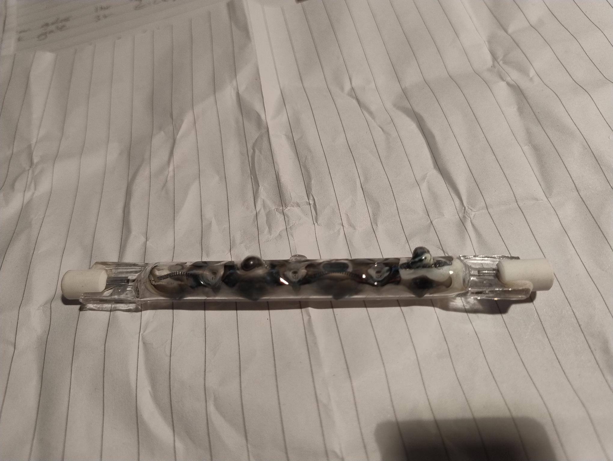

Bulb elements can collapse and short circuit (back when stuff was made properly filament bulbs incorporated fuses so they didn't knock out the lighting circuit) but in halogens shattering it's more the hot ruptured element hits the glass and the thermal shock is too much, easier to see on this linear, the two blobs are fragments of element melted its way through the glass which has re-set instead of shattering
