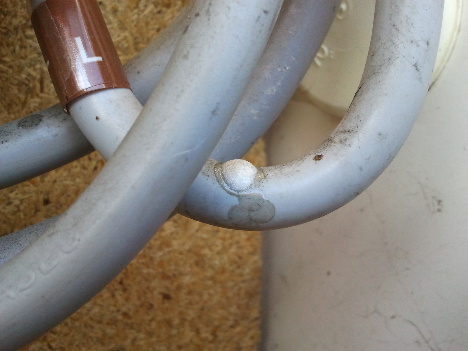

Took this photo a few days ago. Lots of cabling had been affected where several years ago the "cavity wall people" had blown insulation and it had found its way into the meter box.
[ElectriciansForums.net] What Polystyrene can do to PVC
A lot of people don't realise why the mains cables are in bags when appliances are supplied in polystyrene block packaging. They realise when they get it back out a few years later and they haven't bothered bagging it! Daz
Your all talking about bygone years, the modern day stuff they use in roof fill insulation with the BS Kite Mark has no affect on PVC cables or pipework, and hasn't done for some years now!! The problem stuff was last used in and around the 70's, so there will still be a good amount of that older stuff about for many years to come!! All the modern blown polly, whether it be in sheet form or balls has been chemically changed to stop the platicising effect to PVC cables and the like!!!
Interesting point raised about the all insulation. Is some of this stuff polystyrene? If so, how many houses with tails run in the cavities have had this done? Daz
That's what I was thinking. All those cables getting eaten away over the years. Bearing in mind the PVC/polystyrene issue has been known about for such a long time, it makes you wonder how they ever thought it was Ok to do it. Daz
A friend of mine has just bought a house with t&e run in the cavity and polystyrene balls blown in at some point. What advice should I give him? Do I do an IR test every few months to keep an eye on things, or tell him to rewire? Since he's re-decorating I could chase the walls etc, but the painter's already done two rooms!
can't you inspect at the top of walls and the back of sockets etc?
I've seen a few cables over the years with insulation visibly damaged by polystyrene but never to the extent of a conductor being exposed or it having an effect on an IR test or causing a fault.
