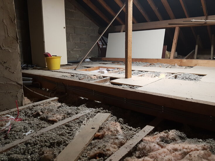

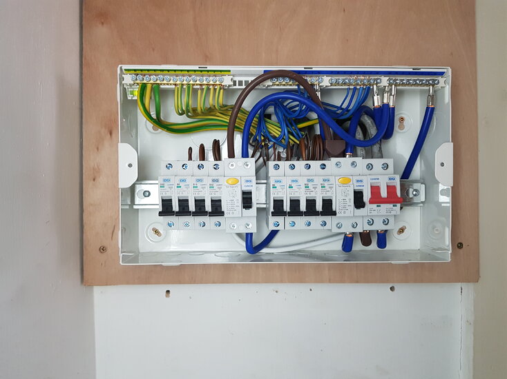

I put some impromptu pictures of the install up and no one has said anything bad or picky???
This is not normal behaviour and I feel quite left out.... almost abandoned:(! For heavens sake chaps I'm a Electrical Trainee (well, 6mw)... where's all the bashing!!!
However, I can understand it if you all feel that I'm perfect :D
