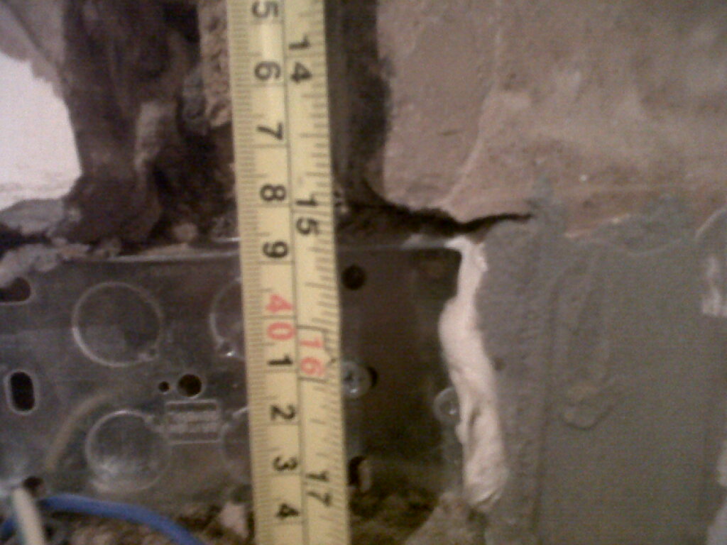

When someone leaves out under 16" of cable from one point to another! Can't believe I've found this again. Whilst fault finding and rectifying a fault that was causing the RCD to trip I stumbled across a second fault. Seeing that the circuit was protected by a 32A breaker I carried out my end to end continuity test first... Doh! Walked around knowing full well everything had been reconnected but double checked as it was on all three conductors. Turns out after quite a while of investigation that it could be only one thing, the ring was never a ring. Ran a piece of cable from one outlet to the other I suspected and sure enough tests proved that someone had never installed the last 15-16" of cable! [ElectriciansForums.net] When is a Ring NOT a ring?
When someone leaves out under 16" of cable from one point to another! Can't believe I've found this again. Whilst fault finding and rectifying a fault that was causing the RCD to trip I stumbled across a second fault. Seeing that the circuit was protected by a 32A breaker I carried out my end to end continuity test first... Doh! Walked around knowing full well everything had been reconnected but double checked as it was on all three conductors. Turns out after quite a while of investigation that it could be only one thing, the ring was never a ring. Ran a piece of cable from one outlet to the other I suspected and sure enough tests proved that someone had never installed the last 15-16" of cable!View attachment 9602
Amazing. So they couldnt even be bothered to crimp/heatshrink to extend their bad measurins' ?
Very lazy.
