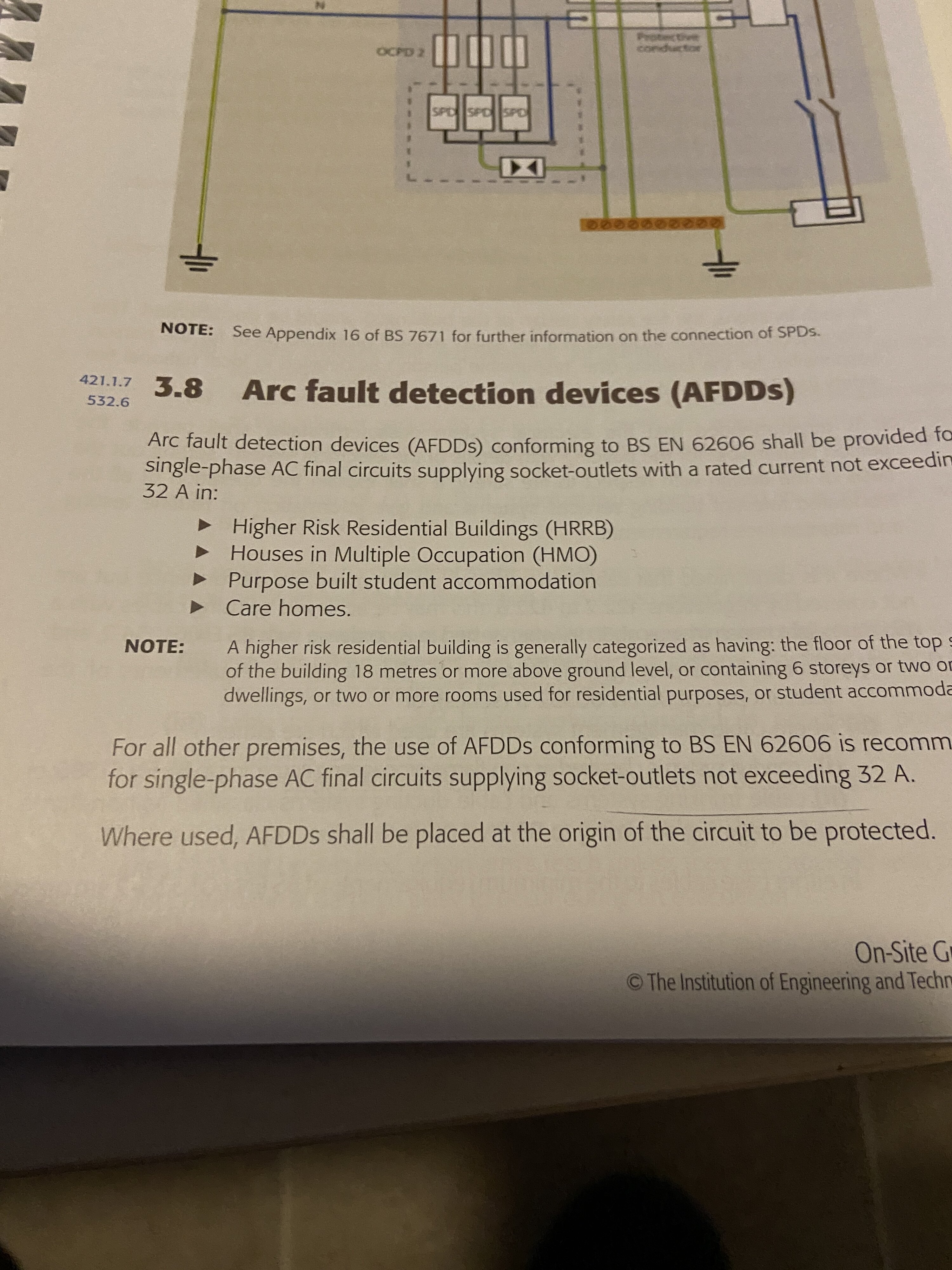

We currently install industrial washing machines, driers and finishing equipment. These can be three phase and single phase. Normally no greater than 32 amps.
When on a commando socket we will install an AFDD.
If we remove the commando socket and install a standard rotary isolator, do we still need to install the AFDD ?
AFDDs are usually put in at the source, at the fuse board and would cover all circuits.
If AFDDs are specified, then it won’t matter if it’s an isolator, or a plug/socket… it should still be fitted.
Can you give us the make and model number of the AFDD you normally fit?

All socket outlets up to and including 32A (which are commercial, not domestic) are required to be 30mA RCD protected. By the sounds of it you...
