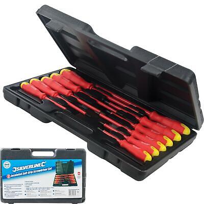

A few years ago I once bought a set very similar to this...
For about a tenner to see if they were actually any good, and to my surprise are ok. They don't come out very often other than the small flatheads I sometimes keep in my pouch.
But considering the cheap price have lasted quite a while.
