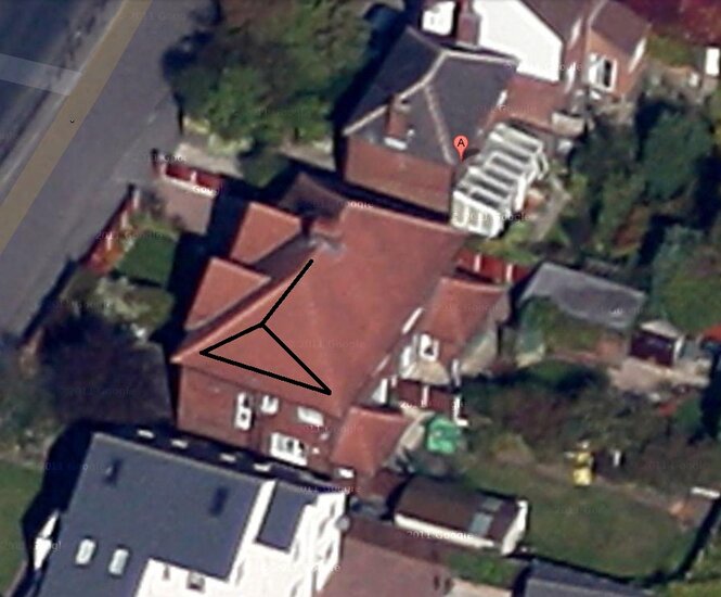

I put my postcode into good earth, and i found my house.
But which way is North and South?
Thanks
Is that mean my roof is South East?
  • [ElectriciansForums.net] Which way is my roof facing?

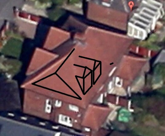

Nope thats the way My roof will be.
Once the hip to gable end conversion has been done,
and two dormers on the back it will look something like that.
One thing I am currently discussing with my builder is to extend my roof eves so it can accomodate afew solar panels.
(How big are they?)
Thanks
Easiest way would be to make the North East wall a gable end, (same as you are planning to do to the Sout West wall) however you're going to get some shading from those new dormers :)
I am doing this under permited development.
The problem is if i do that, I exceed the 50m3 space allowed.
and I hate flat roofs!

I'd expect that would be next doors roof you're discussing, but could be wrong.
ibby - I really don't see that you're going to have space for a solar system with that layout. Could you not drop at least one of the dormas and put a window in the gable wall instead?
I dont have enough head room for the stairs if I dont convert the the Gable end.
The Dormers are needed because I would like two double and a bathroom upstairs as well.
If your house is a semi - looks like PV is a gonner then, however you might be able to do some solar thermal. (Sorry nearly all the houses round our way are detached, so I assumed it was a big detached house ...)
is it a semi-detached, or detached?
If it's a semi, then the most you're going to manage is a row of panels in landscape above the new dormas, and that's if you have the space above them, plus maybe one extra panel to this side of the dorma. You'll probably need to install this before the ridge goes on as well, to allow the brackets to get mounted below the top tile.
You'd get a better return / greater benefit from solar thermal bearing in mind with a new bathroom there'll be a bunch of plumbing to do anyway.
