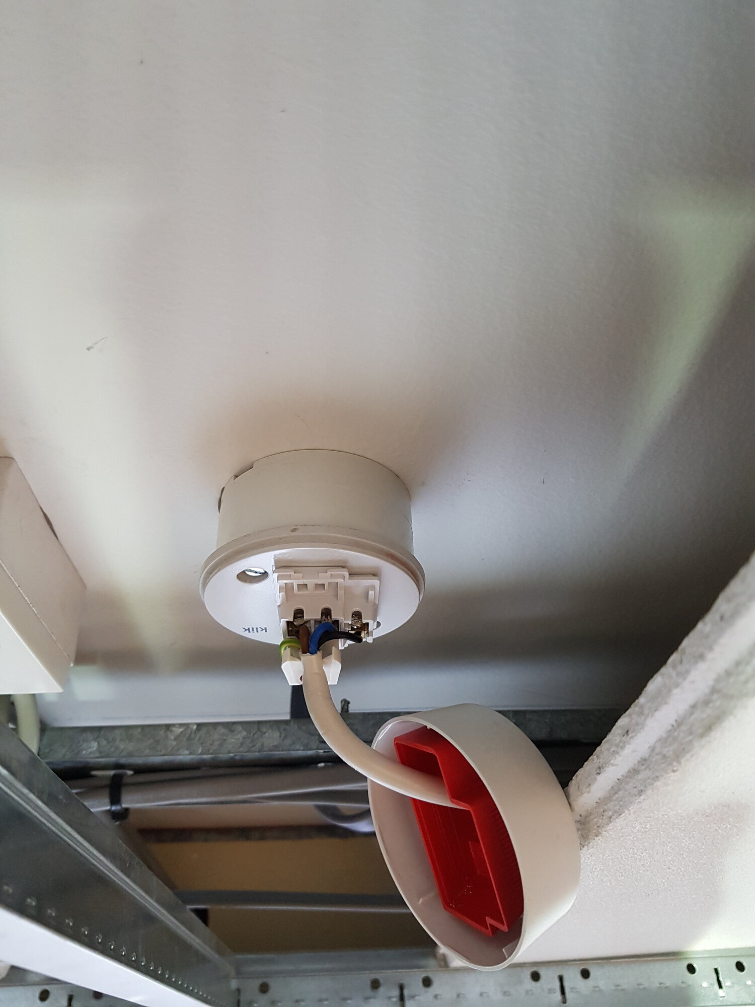

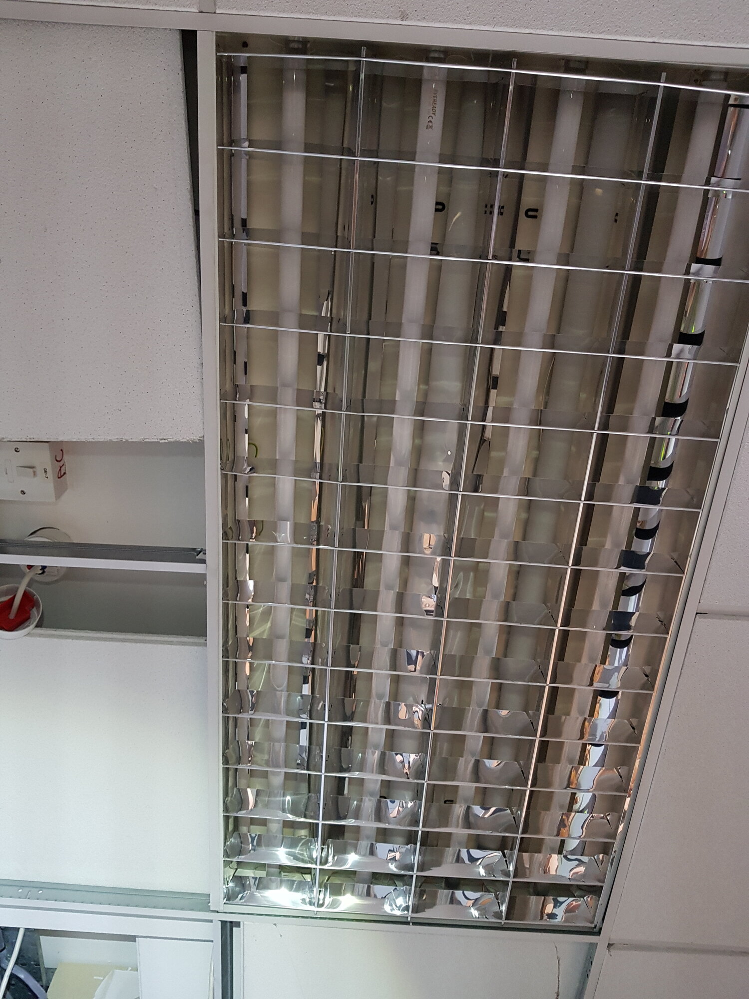

Could anyone tell me why there is a PL terminal for this light? Most domestic ceiling roses have a PL block in order to link in and out, but this light actually has a 3 core and earth going to it. This is not domestic, it is going to be a new charity shop.

So is the emergency light located within the light you see in the picture? I'm guessing it must be, otherwise there would be know point in a PL going to it to charge the battery?
The reason I ask, is because when I switch power off, no emergency light comes on. I also can't see any emergency light. At least not in the same room. Another emergency light in a different room comes on though.
Emergency lights will have an LED usually red to indicate charging, and will be heavier due to the battery’s. Some have a remote battery pack that would sit on top of a normal fitting.
the emergency part of the fitting may only light up one of the four tubes.
you’ll have to get into that fitting to see if it’s emergency or not
Charge indicators are now green. It may not be an emergency the PL may be floating in the fitting the only way to find out is to remove the diffuser as sometimes the charge indicator can be hidden when someone removes and replaces it. Klix produce ready made plugs and cord sets so maybe they just fitted those everywhere although that would be unusual.
I had a man from the council try to tell a client that a red indicator shows a fault and he suggested the client should find a better electrician who would have advised her this was needing replaced! ?
