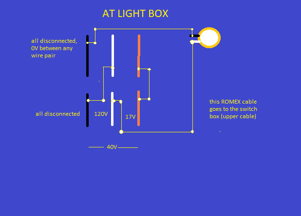

Today, I spent 2 hours to understand what is there in the switch box and the outdoor light box.\
Then spend another hour to draw the 2 diagrams, one each.
The light box contains 2 ROMEX cables, upper and lower as shown in the diagram below.
Voltage measurements (all wires are disconnected, light fixture removed), are also included in this diagram.
Much better than 1000 words.
The lower ROMEX appears to be the feed line.
MYSTERIES: 17 Volts between neutral and ground
40 Volts between hot and ground.
Connections are presented by yellow lines.

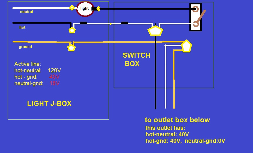

[ElectriciansForums.net] Why low voltage (40 Volts) at outlet

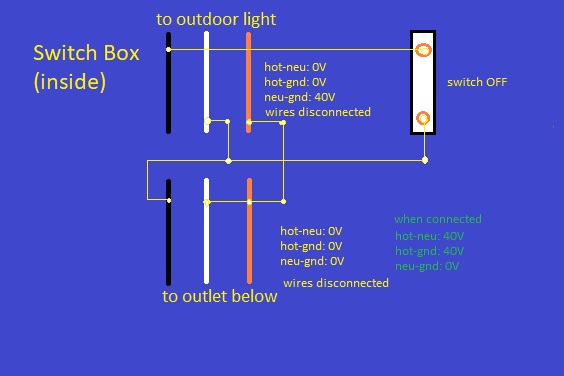

And the switch box also contains 2 ROMEX cable, upper and lower.
It is interesting to note that only 40V is measured between neutral and ground of the upper cable.
No voltage (0 Volt) everywhere else. The diagram clearly shows why the outlet has only 40 Volts between hot and neutral, same for hot and ground.
Pls note: crossing yellow lines without the yellow DOT, mean no connection.
FOR NOW: I have wiring information of these two boxes, still have two mysteries mentioned above.
That is where I am. Will continue to study the diagrams to see if they are done correctly or not.
Any help & idea are greatly appreciated. THANK YOU.
The wiring in the light box appears to be normal and correct (although the voltages are not). The black power feed hot goes to the white of the switch leg (ideally there should be a black tape marking this as hot) and the switched hot returns, goes through the lamp and back towards the panel via the white neutral. The ground is connected through. The wiring in the switch is correct as far as the switch leg is concerned, again the white being the hot should preferably be marked. The hot arrives on the white, passes through the switch and returns to the light via the black.
The problem seems to be a broken ground wire upstream of the light, which will not affect the operation of the light, but due to the way the outlet is wired, it could be particularly dangerous. The outlet gets its black hot from the white hot of the switch leg, but then it uses the ground of the switch leg as both its neutral and its ground, since there is no neutral available at the switch position. The voltage suggests that the ground wire is broken / disconnected upstream of the light, therefore current from the outlet neutral trying to return to the panel could make exposed metal that is supposed to be grounded, live instead. It is a more serious issue than a broken wire that is just a ground. THERE IS A HIGH RISK OF ELECTRIC SHOCK AND I RECOMMEND DISCONNECTING THE OUTLET, AND HAVING THE CIRCUIT CHECKED BY A PROFESSIONAL.
I don't know whether using the ground wire of a general purpose branch circuit as a neutral was ever acceptable under the NEC, but in the event of a cable or connection failure as it seems you have here, it causes an increased risk of electric shock. There have been exceptions such as 3-prong 240V dryer outlets but they are deprecated now. Perhaps a US-based contributor can confirm whether this configuration ever complied with code? Combined neutral/ground conductors in branch circuits have at times been permitted in some countries but not here in the UK with normal house wiring systems like Romex.

The outlet is wired based on wire color. However, as you said, I have disconnected the wires in the switch box that go into this outlet. So the outlet has NO POWER at all, and marked it as such. I do not like to see an outlet with wrong voltage.
And the wiring at the light box appears weird to me but after checking, it is correct as you said. I found a picture on the Web showing wiring diagram when the power source is at the light box. It is exactly as you said. Will add black tape on both ends to show that white wire is hot.

Here is the updated wiring diagram, much easier to understand. Please disregard the diagrams in previous posts. I am also creating a video showing why I got 40 Volts at outlet.
From previous updates, I identified the issue is mainly caused by open ground circuit in my bedroom, this circuit also feed the outdoor light which is on the wall outside my bedroom. The mysterious 40V and 18V goes away when I unplug a power strip from the outlet in my bedroom. Other power strips do not exhibit this symptom. And the power strip above do not cause any voltage anomalies when plugged in a good outlet.
