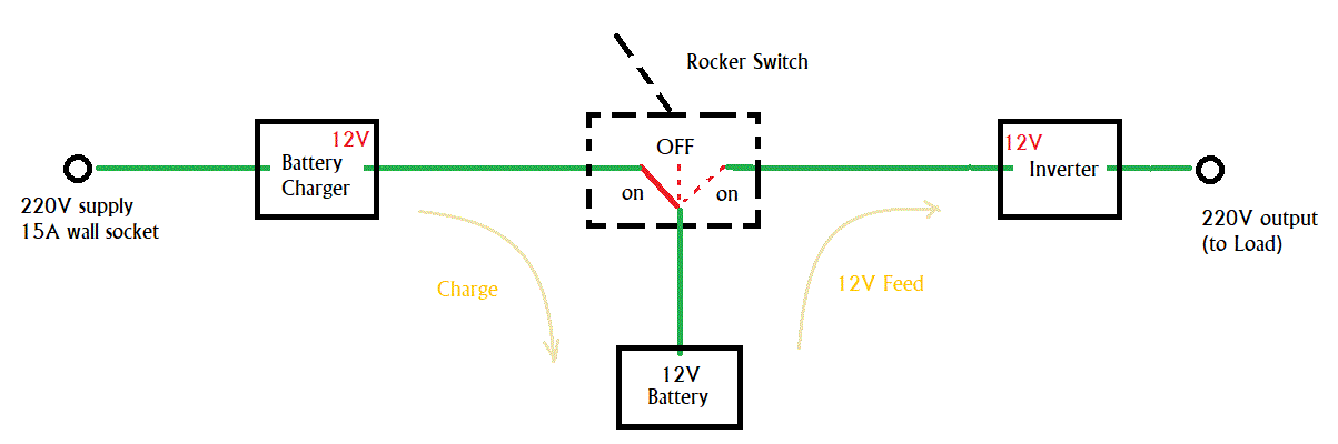

I have an inverter powered by a car battery that I use when 220V power goes off (see block 1 below). I use a battery charger to charge up the battery before I can re-use it (see block 2 below). Id like to connect these devices so that the battery is charged when 220V power is available. (A mains power switch is needed for the charger thats not shown here). A relay is required to switch from the "charge" position to supply the inverter when mains power is lost.
Will a 16A 24V relay work for this? These relays are typically found in vehicle applications. Or am I missing something? Any recommendations are welcome....

Unless I'm missing something here, isn't it just easier to run the battery charger 24/7 and use a relay on the 230 line side of the inverter??
The 230V transfer switch is a whole different kettle of bananas. The OP hasn't mentioned it yet and I've avoided the issue. If it were me, I would leave the battery charger permanently connected and hack the inverter to give a remote standby, controlled by an opto-isolator from the mains. But can't really advise that to a DIY poster.
Actually, @DasDIY, how were you going to switch over the 230V AC side of things? If you are doing that manually, can't you switch the inverter on manually and save the complications?
