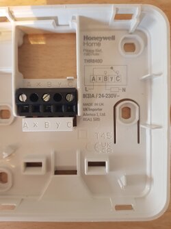

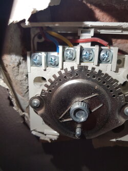

This is my old thermostat and I'm trying to connect to a new D2 model but not sure with there being 4 wires. Wasnt expecting a yellow wire??

Red A
Yellow B
Blue (neutral) not required in the new thermostat.
The old thermostat has an accelerator to improve accuracy, which needed a neutral conductor.
The new thermostat does not have this feature.
Connect the blue into a connector block and tuck it out of the way.

So A would be red, B would be yellow, and would I put the earth in C or just snip that off as it wouldn't be needed?.

Don't snip the earth, as it may be needed in future. It should be sleeved green and yellow and terminated in a connector block.
DO NOT connect anything into C, unless you want to hear a bang!

both wired as stated but not getting no response from the boiler!. Turned the thermostat up to 24 degrees just to make sure and still nothing.
Any ideas??
Just to add, boiler works fine when heating hot water.
