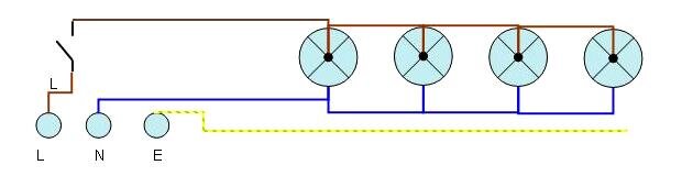

Hey everyone I would appreciate your help with something.
I am making a sign at the moment and am wiring it with lights. I have purchased E27 4W bulbs and holders, I plan to chain a number of lights together on the one circuit roughly 15. I am wondering what wire I should purchase to do this and also can I simply purchase a Keetle Plug Connector and connect that to the lights? I'm not going to burn down the house if I plug this in am I? lol
Thank you for any help that can be provided.

I=P/V and your using 15x4W=60W, 60W/230v=0.261A or 261mA
Kettle lead IEC 60320 (had to look that up, as all i remember is the IEC bit)
0.75-25mm Cable if you like (smaller is cheaper)
Just remember the CENTER of a Eddison Light the Live goes to.

And I am correct in thinking that in order to chain them all together all that I do is run a cable between each bulb? Obviously ensuring that the Live goes to the Centre of the next bulb?

The bulbs I have are 220-240V and the holder is rated 250V. Will these Kettle Connectors work?

Also because the bulbs are 220-240V does this mean I would need to use a 230V Kettle Lead to plug it in? Would a 250V do any harm?

The rating of the IEC kettle lead is its maximum voltage, so anything less than that will be OK.
The voltage supplied from the mains will be 230V or so this is the key point and the votlage to which you are working.
The kettle lead, lamp holders and switches are rated to be able to be used at this voltage.
The switches that you have linked to are designed to be mounted on a thin flat metal panel, which will be fine if that is what you have, and will require a securely rigid surface to fix them into as they will be subject to strain on inserting / removing the plug.
Only if you had an item specified at say 30V or 120V would this be dangerous to connect to your system
If you are unsure then it would be best to start with one bulb so that you can assess problem in a step wise manner.
Do not power the system until it is in a safe condition to be switched on.
Good luck.
