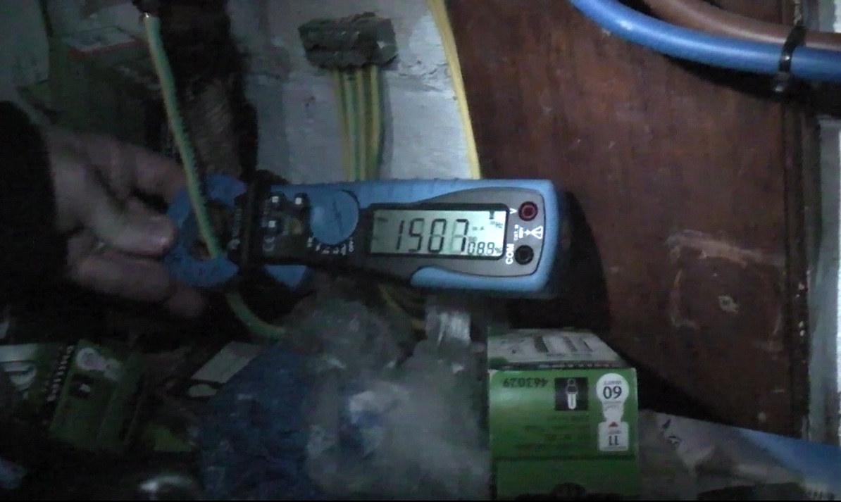

I have been looking into a suspected earth leakage problem.
I have purchased a Metrel earth leakage clamp, and started by measuring what I expected would be the earth leakage on the consumer unit by clamping the main earth into the board. The clamp metre was fluctuating rapidly and reading between 100mA and 150mA, so that confused me as at least one of the RCD’s should have tripped with that much leakage.
Then I clamped the Gas and Water bonding. One read between 100 and 150mA, the other read between 200mA to 240mA.
Then I clamped the main distributor’s earth lead from the incoming supply to the MET, and this time I read between 1000mA and 1250mA.
I switched off the consumer unit main switch and set the clamp meter to read amps not milliamps, and even with the consumer unit turned off it still read 1.2 amps.
I tried my Megger clamp meter and that confirmed that with the consumer unit main switch turned off, there is about 1.2A flowing through the main earth cable.
Later I tried the Metrel meter at my house and it read a steady 5.5mA current through the main earth between the supply earth and the MET. I then turned off my home consumer unit and the reading dropped to 0.5mA, which I assume is background and nothing to worry about.
I also tried plugging my kettle into my PAT tester and clamped the Metrel meter over an exposed earth wire (in an adapted extension lead) and the PAT tester said the leakage was 0.55mA using a differential calculation, and the Metrel meter said it was 0.47mA, so it only differs by 0.08mA so it looks like the Metrel meter is working correctly and reasonably accurately, and there really is 1.2 amps coming from somewhere in my client's house.
I am not sure what to do now. Does this mean there is a problem with the distributor's earth? Or am I misinterpreting the results?

If this house is on a PME supply then there will be neutral currents going to earth through the earthing and bonding conductors which as Tony says won't affect the RCD as these currents do not come from the final circuits. They flow from the incoming neutral, through the main earth to the MET then through the bonding conductors to earth and then back to the supply transformer. If your own house is TNS then you don't get that effect.
Did you try clamping the L+N together? That should be steady and will give you the total residual current for the house.

your RCDs will trip due to a difference in the currents flowing in L and N, so, as mjvor said, if you clamp L/N together, any reading on the clamp meter will be the difference.

The DNO engineers turned up at 9.00Pm on Saturday. The engineer's notes on the job notes say there was “No Significant Current between the head and MET”, so I went round at 9.30pm the following evening and measured 1.2 Amps again. Then I went back today to try and find the leakage problem, and there it was again. 1.2 Amps, so I guess the DNO engineer was unlucky and arrived when the problem was not happening.
I tried the idea of clamping live and neutral and measuring the difference (leakage) and that did work. I was easily able to see that my fears that the earth current might be leaking into the neutral cables was unfounded as I turned all the MCB’s off, and although there was still the 1.2 amps on the earth cable, there was 0.00mA on the neutral cable.
Then I set about turning on and off all the MCB’s and noting the leakage. It turns out that there is a problem on the Kitchen sockets (8.4mA leakage) and the total leakage including the kitchen sockets is 19.1mA, and the RCD test says the RCD will trip at 19.0mA, so it is right on the edge of tripping all the time.
I am trying to identify if it is a faulty item of equipment or if I need to be IR testing the circuit and finding the problem.
You've not understood what I said above. Current in the earthing conductor is normal if you are on a PME supply. It flows from the supplier's neutral through the earthing conductor and through the main bonds back to earth. It is not causing the RCDs to trip. The only current which does this is the leakage current in those circuits. Use the IR tester to identify where the problem is. Could be water in a JB somewhere or damage to a cable. Make sure everything is unplugged.

I forgot to mention in the first post, this is a TN-S system. The MET is fed directly from a cable attached to a clamp round the incoming mains.
