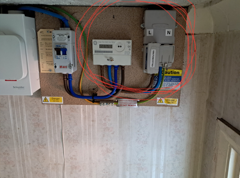

In fitting the new cutout your electrician has created a TNCS / PME supply which depending on the local DNO network setup may or may not be available locally
On a TNCS supply the neutral conductor is also used as the earthing conductor

Normal electricians shouldn’t be touching the cutout or meter, circled in red here….
For a property to not have an earth, that’s an issue for the supplier, not for someone to invent one from thin air.

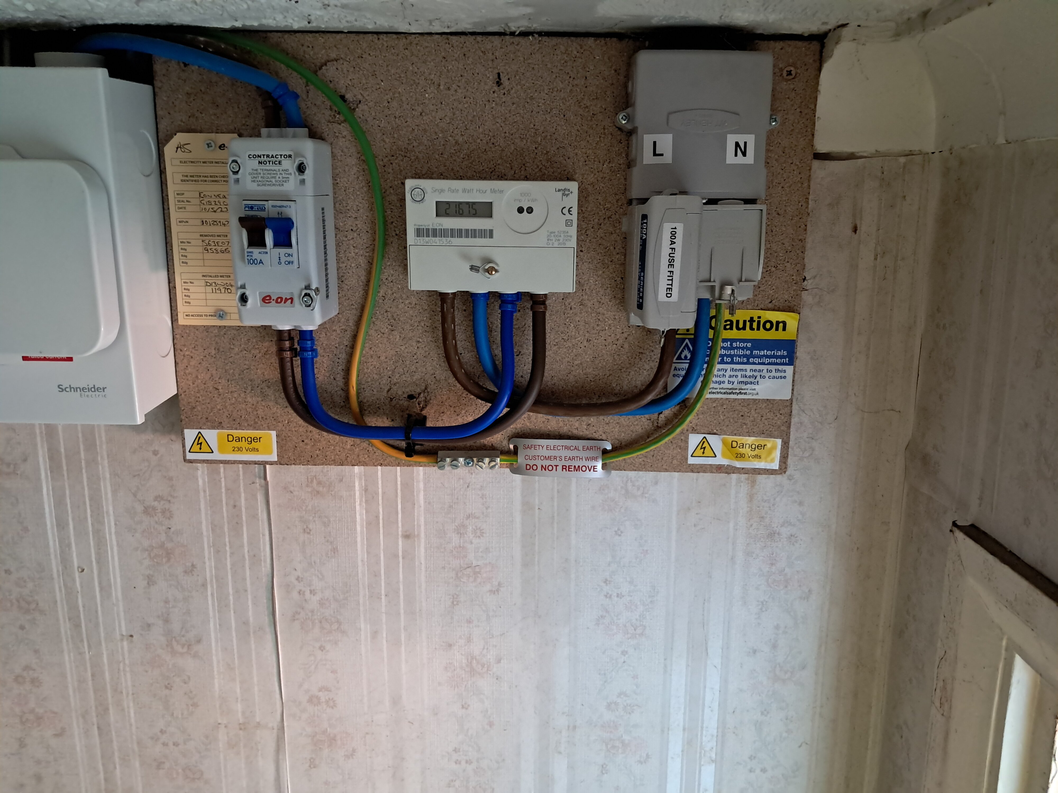

You say there’s an external fuse? Is that in a box outside? I would think the meter should be there too.
Can we see a photo of this external fuse?
Sorry when I said external I mean that bump on the outside of the henley. It's not hidden away inside the unit or anything. I'm not an electrician but an interested novice.
The cutout box was installed by regular electrician after they said all the original sockets werent connected to any earth. the meter was installed couple of months later when eon said our spinning disc one was no longer reliable, not that I believe that, they just don't want ones that you can ubse magnets on! Still I'm happy with a dumb digital meter

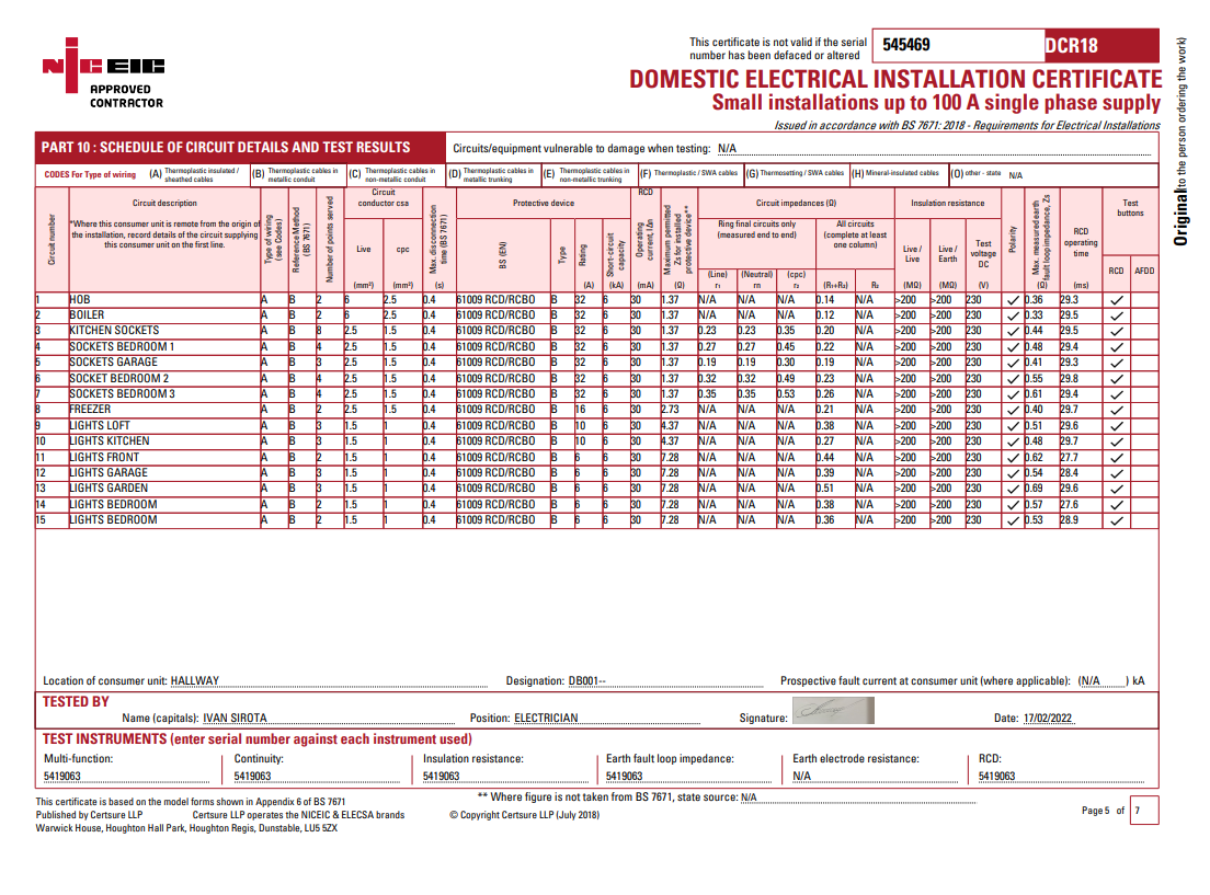

Did the electrician who joined the DNO earth with the inline connector do any Earth loop impedance tests anywhere afterwards did he not give you a Test sheet of any kind?
A regular electrician has not done that head replacement just the earth terminal and do not disconnect notice suggests DNO.
I can't make up my mind on this one whether it is a DNO swap or not as it would not be beyond a very experienced spark to do it or an ex DNO spark
I think we did get some sort of test sheet by email but I think that was just for the consumer unit box. I'll try and find it
It's very unlikely that an electrician replaced that cutout.
It has been carried out using DNO materials to DNO standards, the most likely explanation is that it has been carried out by the DNO
Certificate 2022? Test voltage 230 on IR - I'd expect that to be 250 or 500 if equipment disconnected (well that's what my MFT has).
5 Ring circuits seems mad. 7 Lighting circuits too!
