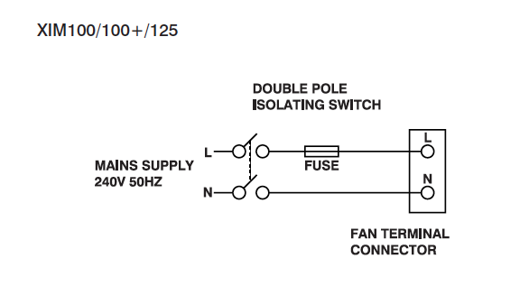

hi, I'm in need of a little help, I have bought an inline extractor fan, the booklet shows I can fit a 3 pin plug to it or hard wire with a switch, I want to use a plug but I am not sure if I have wired it on correct as it has no power, I was wondering if anyone could advise, the diagram shows
L1 Brown, L2 Black, N White and my plug of course is brown, blue and earth, I have tried the live in L1 and L2 and get no power
thanks in advance
Hm
The diagram I have shows this
[ElectriciansForums.net] Xpelair XIM X 100 inline extractor fan
Which looks easy peasy
I've shown you mine, can you show me yours?
(diagram I mean)
You need to put the blue on N
and the brown on L1 or L2 depending on if you want high or low speed.
In the drawing they have shown a separate switch, so you can select the speed from the switch.

I'm familiar with many domestic extractor fans which are primarily class 2 (double insulated) and consequently are not required to be earthed...
I think you are going to need an electrician because it looks like someone has used the bare earth (has been sleeved black) as a live conductor...
