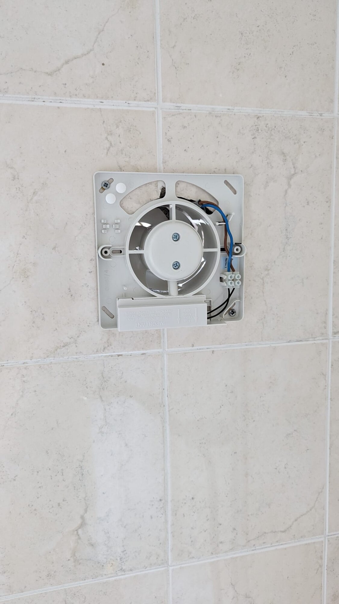

Need to replace an old Vent-Axia extractor fan as the pull chord no longer works.
I bought this - https://www.amazon.co.uk/dp/B00CBX254I?psc=1&ref=ppx_yo2ov_dt_b_product_details
I went for this one as it only required a Live and Neutral feed. I installed it but nothing happens when I switch the electricity back on.

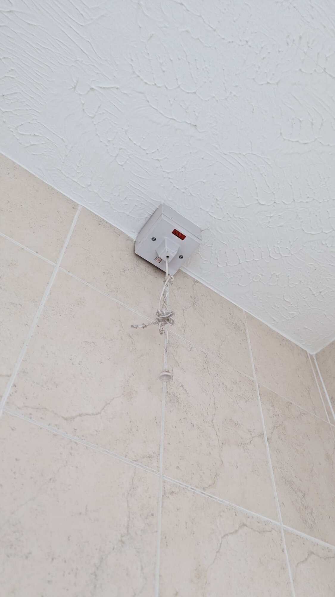

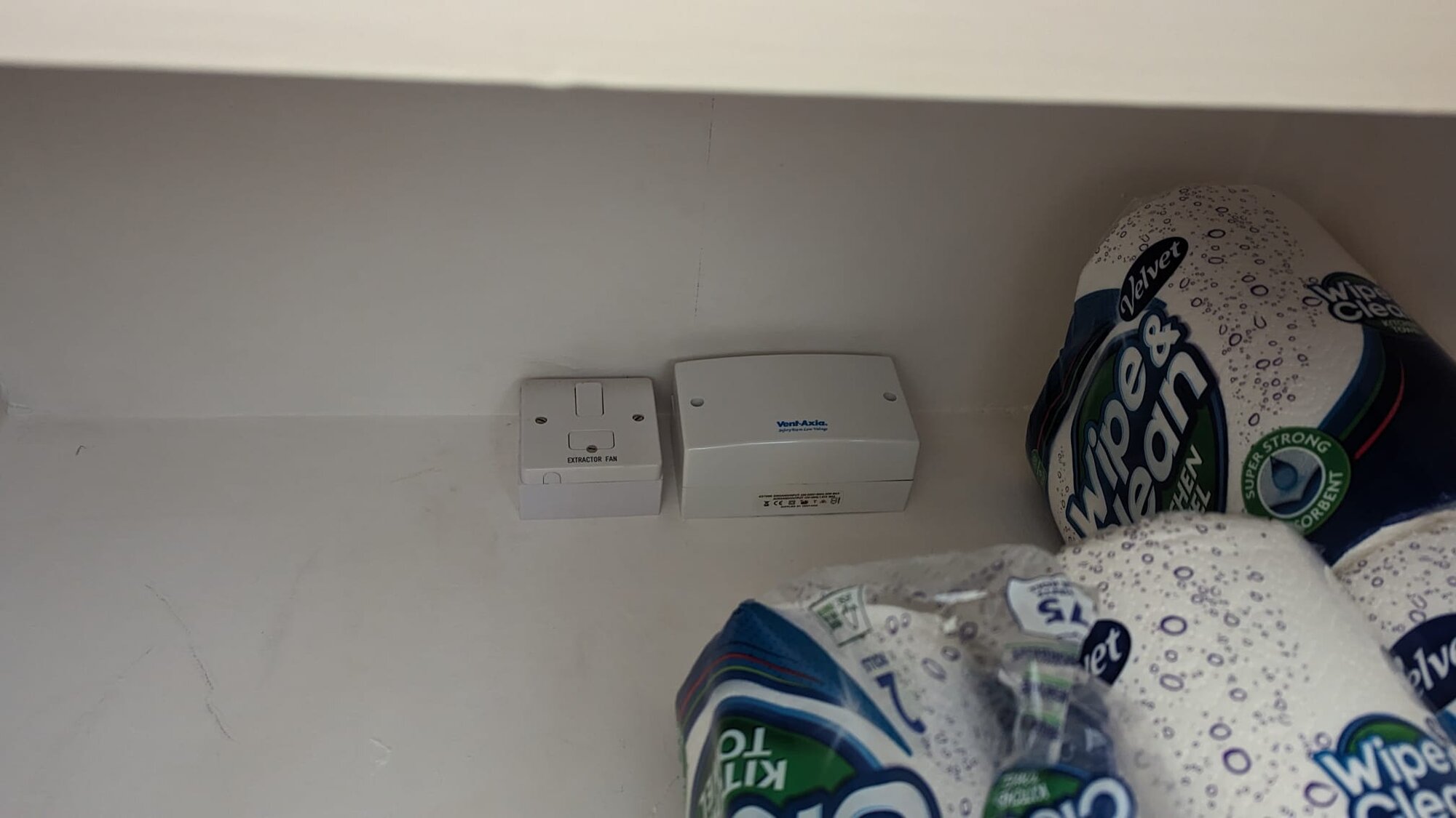

I noticed there is a Vent-Axia control box of some sort in one of the landing cupboards, could this be the reason the new one isn't receiving power? There is also what I assume is a pull chord for the shower on the opposite side of the wall from this, which I have never touched and is always On.
Is it something to do with the new fan having a permanent live rather that a switched live?
I've attached pics of the new fan (upside down I know, had to for the wire), old fan, in cupboard control box of some kind and in bathroom switch.

Your old fan was 12v which is what the controller is for, it converts 230 to 12v. Your new fan is 230v.
IPX4 230v extractors are pemitted in zones 1 and 2 .
Only in the highly unlikely event of the OPs fan being installed in zone 0 or there being no additional protection to the circuit would it need to stay 12v

I never said they weren't allowed given that the OP is DIY I was just pointing out that the simple fix of removing the transformer may not be an option without the OP posting further information on the existing electrical installation, taken the wrong way some advice could be dangerous
Thanks all. From what I can see on Google the fan is installed in Zone 2.
Should I just get a 12V fan for ease or look into removing the transformer? Is that even something I can do myself?
I do have an electrician friend but he is always very busy so don't like to bother him too much.
A 12v fan would probably be the easiest solution
Removing the transformer could also be possible but would ideally need professional advice as to whether the existing installation would allow safe and compliant use of the 230v fan

Isn't the pull cord on the ceiling your shower isolator? If so, does it also control your fan? If so then I wonder if it is fused down anywhere?
Yea the one on the ceiling is the isolator, I have never turned it off. But also the old fan had a built in chord which I would switch on when I hop in the shower to start expelling straight away. It would also come on by itself if it detected any humidity.

It's unlikely that the pull cord on the ceiling will be connected to your fan, but it's possible.
The ceiling isolator should only ever be used if any maintenance work is being carried out, and should not be used as a general on/off switch for anything.
I'd get a replacement fan which has a built in pull cord. 12V ideally to save having to worry about removing the transformer.

I'm not sure what the pull cord on the ceiling is for then, I figured that as it's literally about 6 inches through a wall from the fan switch and transformer in the cupboard that it'd be part of that system.
Thanks, I'll have a look for one.
Do you have an electric shower? Or did there used to be one?

Do you know whether the transformer for the fan is 12V AC or 12V DC?
Do you know if the transformer actually works?
