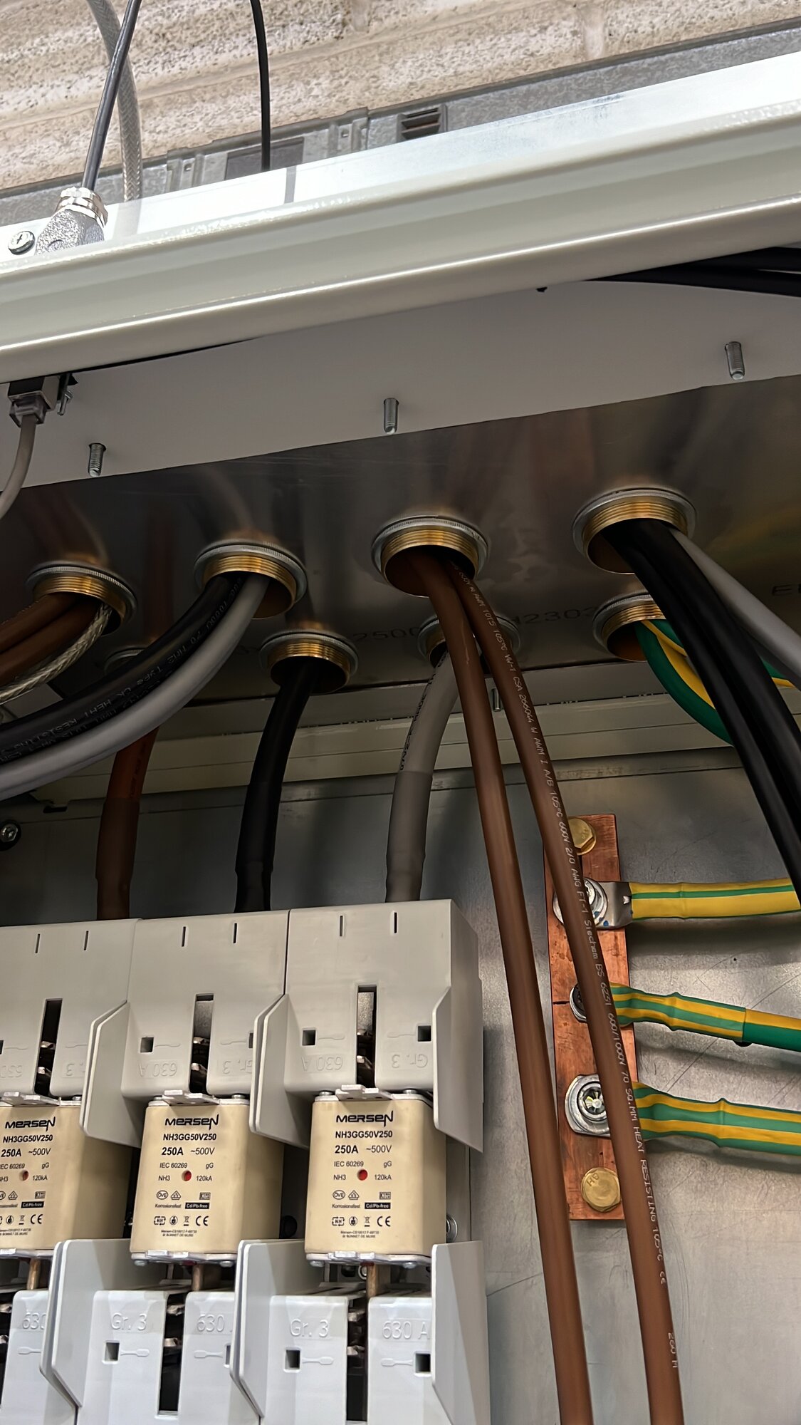

hi all,
What are your thoughts on how the 6231 cables been terminated? Will aluminium cause eddy currents? Thanks

There might be some eddy current effects but far less than for steel (or anything other exotic material that is ferromagnetic). See 521.5.1 for that.
Ideally you always would take the whole set through a single hole, it also helps preserve circuits when several are present so less connection errors (i.e. L1-3, N & E kept to same MCB, etc, etc) than if they are going via different holes.
Yes aluminium is a good conductor, so eddy currents will be greater than if it were steel.
Whether in practice anything bad could happen I'm not sure
Unless I'm very much mistaken the issue of eddy currents only materialise in ferrous materials. Gland plates are often made of aluminium where large singles are brought into an enclosure.
Seems I am mistaken - thanks 🫣
You are not mistaken, eddy currents (Foucault currents) will be induced in any conductor within the presence of a changing magnetic field.
However the ferrous material tends to enhance the effect.
I have to say though, we designed MV and HV switchgear for typical currents of circ 630 - 3000 A and using 1/4" steel plate we used separate apertures for each phase, and only added around 5-10 deg C temperature rise!
So in my opinion it doesn't matter at all whether the cables go through the same hole or different holes.
However if it is ferrous material, regulation 521.5.1 mandates that all current carrying conductors go through the same hole.

Yes it does, I think this is down to the fact a lot of current can flow through it under fault conditions.
I guess the other side of that is it might add some impedance to the system due to inductance, making the AC R2 a bit higher than the DC one measured during dead testing to verify conductors are properly speced and installed.
Eddy currents are a real thing, I have seen several instances of damage by them.
The worst case was on the LV box of a 2MW transformer, four conductors per phase all neatly grouped by the phase and taken through a steel plate. The paint on the plate had burnt off around the cables and discoloured the steel. We changed the gland plate to brass to solve the problem. Interestingly at the other end the singles were again taken through steel into the switch board but there was no sign of heating, I think this was due to the singles being taken in randomly rather than bunched in phase groups.
As said above there will always be induced currents from singles but it is much worse if they pass through ferrous metal. In another case we had four singles passing through a steel plate, again there was signs of heating. This was solved by cutting a slot to link the four holes (which were in a line) then brazing it shut again to retain strength. The brass in the brazed joint was enough to prevent further eddy current damage.
I always thought they had the same effect on brass as I was once told brass bushes wouldn’t prevent the issue or is that because the brass bushes are drilled and fitted to the steel casing of a distribution board?
would not a brazed up slot still count as a shorted turn of a transformer os sorts?
It is conductive but not magnetic. The braze stops the magnetic circuit and forces the magnetic flux from all the cores to go around all four cores. The sum of all the cores should be zero so there is no magnetic flux left to induce currents.
You are correct. Brass bushes in a steel plate will not make any difference. You have to look at the magnetic circuit, all the cores have to pass through the same hole in any ferrous material.

That is correct, A changing magnetic flux will induce current in a conductor, but by putting all the cores through the on hole in a ferrous material the magnetic fluxes cancel out, hence no induced current.
If the cores are brought through separate holes in a ferrous material each will induce a current. These currents will summate/negate and produce losses which can result in hotspots. I agree with a comment above that below 100A there will be no heating, But it is still an inefficiency.
