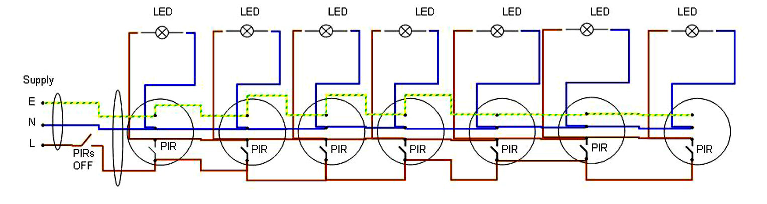

I have a customer that wants seven LED flood lights fitted controlled by several PIR's. but he wants all the lights to come on if any pir is activated I need wiring diagrams for the installation

Although, with the inrush current on LEDs (esp on lampposts where you've a very big bright head), you might want to consider using the PIRs to switch a contactor first, or I can see this burning out a lot of PIRs prematurely.
Yeah, didn't notice they were LED's.... but it only needs one to be operating:leaving:

Have had the issue of led lamps still glowing gently when switched off, snubber worked a treat on more than one occasion 👍🏻

Well conventional wisdom says that you just parallel ('piggy back') as many switch sources as you need, all fed to the contactor coil. If for...

Some pir lights have a switched output so you can link them together, when any pir is activated then all lights will come on. if you don’t connect...
