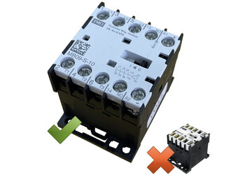

update - I note another outlet is saying the original spade connected IMO contactors are superseded with a version with terminals, and they claim this is suitable for the ESLR9
Thank you both Dave and Avo, food for thought. I did insert a small screwdriver (not the Siemens own tool) into the correct aperture and then articulated the screwdriver to open the clamp enough to insert the wire. The wires went in cleanly and I then released/removed the screwdriver to clamp (but it wasn't very positive and left loose). I will investigate the condition of the wires and replace where necessary, this is something that never occurred to me. The contactor you post above Avo, with terminals, is worthy of investigation - thank you both very much!

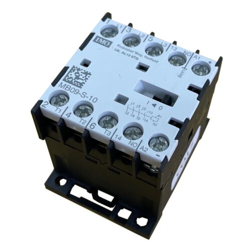

Thanks all the same for the link. Please excuse my ignorance, but why when the maximum power usage of the cooker is a combined 16.5kw, would a contactor rated at 4kw be big enough to cope? Sorry, I am sure this is a stupid question!
There are a pair of auxiliary contacts as well as the set of three phase contacts. As I read the list of performance criteria, the 4kW rating applies to the auxiliary contacts, not the three phases which are shown higher up the list at 22A ea. resistive load.
Mind you three 230V phases at 22A is about 15kW, not 16.5! So maybe this is a bit under-rated anyway - or perhaps there are other loads in the oven that make up the difference!

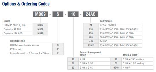

Thanks Avo! I notice on the datasheet for this contactor that they do different coil voltage types. I am a bit confused by these, the 230V one, I assume is for a single phase installation? Mine is three phase, so would I need the -400, the 380-400V 50hz version?
