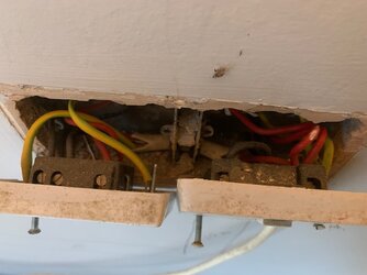

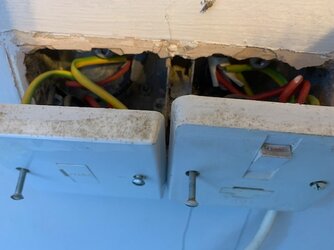

What's confusing me is there are 2 cables coming from above; one's a white cable into the left socket and the other's a grey cable coming into the right i.e. boiler socket. The 2 sockets have then been connected by wires. I've taken photos to try and show what I mean. Confused as to why they are connected?

I misunderstood.
I can't see the wiring clearly enough to work out exactly what's happening, but it looks as if power, eg from a ring red and black, is fed to the right hand fused connection unit, may also be connected to the left hand fused spur (by the small piece of white cable between the boxes), and then the output of that fused spur on the left goes off (up the wall?) to somewhere else, meaning the wire on the left is feeding something, it's not power coming in. That could be checked by looking at whether the wire running up the wall on the left is connected to the outgoing terminals of the fuse plate.
it's possible they are both doing a job supplying power at the moment.
If you think the left hand fuse is redundant, you could try taking out the fuse and seeing if anything stops working!
Did the electrician who's giving you the quote look to see what the two fuses were doing - is it he who suggested they are not both needed, as the pencil lines indicate the two accessories are to be replaced by one.
The cable coming down into the right box which is feeding the boiler is white and the cable coming down into the left box is grey. These are connected by the white cable as seen in the photos. The electrician suggested to blank off the left box and continue the cable from the right box to where he pencilled in just under the boiler. Not sure why they'd be connected by the white cable? There's an external light above the upstairs bathroom which doesn't work anymore so could be feeding that?
The electrician quoted me £90 to move the socket which would involve chasing the wall out. I've left voicemails to agree to the work but he hasn't got back to me which is why I'm on here as need to finish the larder cupboard. Your suggestion of running the cable in plastic trunking on the surface makes sense as a wall mounted socket isn't a problem as it will be enclosed in the larder cupboard anyway. It will mean less mess as well.
Sorry I'm not being clear.
My suggestion is that maybe power is coming down the white cable on the right, (powering the the boiler via the RH fuse) but the white cable continues the supply between the boxes to the fuse on the left, and the grey cable is wired to the OUTPUT of the fuse on the left, so the power is being fed UP the cable on the left to something else.
Just because the wire comes down the wall doesn't necessarily mean that wire starts at the fuseboard. It might be going to supply power to the heating wiring centre for example.
It's just a suggestion that you shouldn't just disconnect the grey wire without understanding what it's doing!
That's why I suggested taking out the fuse on the left (or maybe there's not one in there!), just to check that nothing goes off!
You need to be sure where the power is coming from - is it the white wire (my guess) or is it the grey wire? It should not be both!
Edit: I see there are three red wires at the back of the RH fuse, suggesting that one is on a ring circuit, and is the supply of power, suggesting the other fuse is providing a fused supply to something else. Is there a socket circuit or lighting being fed from it?
