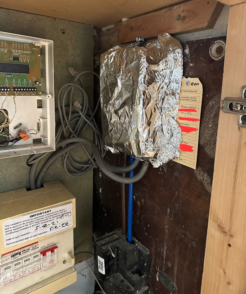

Hey all, I'm looking for some advice to help me troubleshoot my strange issue with my consumer unit/fuse board on which my RCD keeps tripping.
Disclaimer - I'm a DIYer. I have an electrician involved and I'm 100% planning on leaving the work to the pro(s). However, He's not had time to do any real testing just yet, so I thought I'd get the ball rolling as he's said it might be a nightmare to solve.
So, I have an empty property that my recent tenants have moved out of. Near the end of their tenancy, they were reporting that the electricity was tripping throughout the night.
The consumer unit only has one RCD which protects breakers for downstairs sockets, upstairs sockets, the cooker and a single socket that sits next to the unit.
When they moved out I thought it'd be a simple process to isolate the issue (how wrong I was ha ha)
I thought it would be an appliance/device plugged in somewhere but even with EVERYTHING unplugged including the cooker, extractor fan, fridge-freezer, even the boiler, but it still trips… even if ALL the MCBs are switched to OFF.
But, it doesn't trip immediately, it doesn't trip during the day either.
This is where it gets weird…..
It seems to be tripping at the exact time each night, at 00:53 (or at least 3 out of the 4 times I've accurately timed it - the other time was close at 00:15). It doesn't make sense!

I'll post some pictures of both that and the consumer unit (which is pretty old)
Here's the meter and the consumer unit

You need to get some basic tests carried out following a logical process, anything else at this stage is just guesswork.
A test of the RCD to make sure it is working as expected and thorough IR testing of all circuits would be my starting point.
Also the next test due sticker shows that the last person to inspect and test the installation recommended that it be done again within 12 months, this is unusual for a domestic installation and suggests that the previous test report will have identified some issues.
Yes, that's the MEM RCD most often associated with tripping by "Smart" Meter.
Really? I feel like we may be onto something. If it turns out to be that combo causing the trip, what type of action would I take? Is it a fix from the energy supplier side or do I need a new board that's not susceptible to this smart meter triggering?
There are thoughts on how a smart meter can trip an rcd, and although I’ve never come across it myself, there are some solutions I’ve learned from this forum.
Distance seems to be an issue. If the rcd is within a foot or so of the meter, it can trip.
A metallic shield… (bit of cardboard wrapped in tinfoil) between the meter and the rcd creates a barrier. The communication signal can’t get through.

Well, the RCD and meter are very close together. I'll run some tests this evening. After a Google, I can see people suggesting trying to make a phone call on a phone held close to the RCD to see if that trips it.
I'll give the cardboard & tinfoil shield a try too. At least if it stops the tripping I know 'what' the problem is. It's then finding the solution.

It tends to be older consumer units that have the smart meter proximity problem, and the Square D issue is fairly well known. Changing the consumer unit to a modern RCBO unit has a number of benefits (not least that the RCD 'trip' is per circuit not for the whole lot, so you don't lose everything in a fault).
I have had conversations with smart meter installers and MEM RCD's have came up
It is a known issue.
If you call the supplier you can ask them to poll the meter while on the call and see if it trips
They could also send a signal to the meter to put it in to dumb mode (no communications)
Require them to either move the meter or replace the meter with a dumb one

They would simply point out that the old RCD do not meet the EMC immunity specifications that came in around 1996, and so it is really the "fault" of the RCD to be too sensitive to RF, though at the time they were originally made there were few radio transmitters around, and certainly nobody expected one to be permanently located under a metre from the CU!
TL;DR the best option is to replace the CU, both the metal box of the new CU and the use of RCBO (that are now much more immune to RF as they have to be), is going to solve that problem and make future faults less troublesome and easier to trace.
Before that, of course, some systematic IR testing is not a bad idea, but the common time of tripping does point to something timed such as daily reporting of readings, etc.
Bit of an update for you. I first tried creating a shield with some tinfoil wrapped round some cardboard and placing that between the two, but it tripped. I wasn't 100% convinced that it shielded it completely so the next day I just wrapped the meter instead. It's not tripped for 2 days!!!
Also, before I wrapped it, I rang the energy company (that my tenants were with) and whilst I was on the phone to the guy with my head in and out of the cupboard where the boxes are, it must have tripped 6 times. I asked if he was making updates to the meter at the time but he said he wasn't.
Anyway, after not believing what I said he must have done a bit of research and agreed that these concerns had been raised in the past and so he raised a complaint for me. He said that I should expect a phone call to potentially arrange a visit from a field engineer (or whatever it was called). I'll wait and see on that.
That suggestion to get the supplier to poll it whilst in on the call may be a good shout too.
One thing that could be related (or not) is that they tenant took the little tablet/screen that's supposed to tell the customer about how much energy is being consumed - wonder if a poll to that device is happening/failing.
So, I do think a new RCBO is the way forward though and agree that it's worth checking to see if there is a fault causing high earth leakage. I just hope that the energy company recognise it's an incompatibility caused by them swapping it out and offer to change it back to a dumb meter (which I was quoted approx 470 quid to do both elect/gas meters)
