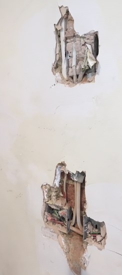

There could also be a completely unsuitable junction box embedded within the wall and tiled over or just cables in choc blocks in old accessory box such as these found on a job that had been plastered over!
Lost count of times have come across something like this!
