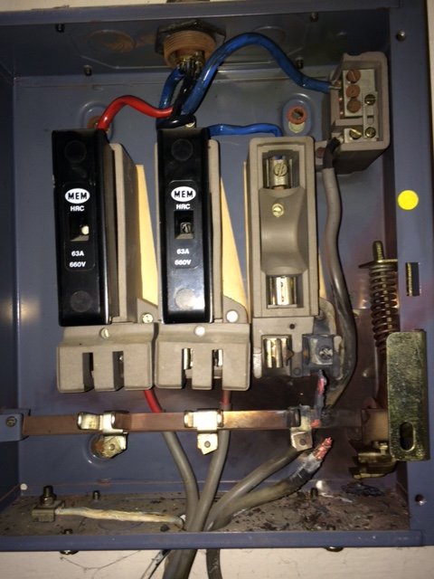

Hi all
The other day a friend of mine who owns a restaurant lost power so I went to take a look for him as I was only around the corner. Upon arriving I found that the tails straight off the meter into the switch fuse had burnt out and one of them was hanging out the box (it was quite a mess and I took photos). As i didnt have any tools on me at this point i couldnt check to see if the cables were safe (although I suspected it had blown the main fuses) so I pulled the main fuses (I didn't cut any tags) as this was the only means of isolation. I then called the electric board to come out and went to fetch my van to take a closer look.
When the man came out he gave me a lot of ---- and wanted to report me saying I put myself in huge danger (in the end he calmed down and said he wouldnt) but Its been playing on my mind. I was well aware of the risks of pulling the fuse but I thought there was a greater risk of leaving it and in the hour the at they took to come out what if i had my back turned and a member of the public had walked in and touched something.
Was he right in saying that I should have just left it because as far as I believe, if something was to have happened they would have said it was the electricians responcibily as it wasn't on their side of the meter. Do you think I did the right thing or could I have handled it any better?

I did think afterwards I could have potentially just locked the area off but the issue was they had a restaurant full of people and the fuse board is in the main stairwell. I was not happy with just putting a barrier around the area. When pulling the fuses I wore flash gloves and a mask just in case but there was no load through the circuits as the switch fuse was off

That is exactly what i thought, apart from it was 400v, my first instinct was to kill the power and normally when i have called them out before they have been really friendly, this one chap was a complete prat. What if someone had entered the building when I had my back turned. Not only that but I had the pressure of getting power back on as they had thousands of pounds worth of tables booked for that evening
