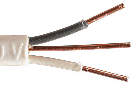

Can anyone tell me more about Twin and Earth American style?
What's it's full name? NM?
Is it always flat?
Do you add a sheath to the ground/earth cable?
Thanks 😊

Main differences of USA NM from UK T+E:
  • Ground conductor is same size as others
  • Core insulation is 2-layer, PVC has a skin
  • NM-B is 90 degree rated, and is now standard
  • Sheath of newer cables is colour coded to identify size
  • Size quoted in the form 12-2 where 12 is the AWG and 2 the number of cores other than ground
  • Colours W & B / W, B & R

NM or Romex is flat for 14/2, 12/2, or 10/2 or 3 conductor. Starting at # 8 or # 6 is normally round. I still can’t understand why we have naked grounds but it’s easy to purchase shrink tubing that can be installed on the naked wire. Be sure and mark it green.

Thanks, I assume it's naked like us for cost? but also the Earth/Ground is normally of a smaller size/diameter than the Live and Neutral.
But I would be interested in there is some other thinking behind the ground being bare. I mean I have known people in the UK say it's for safety incase a nail is driven into the cable.

The ground is the same size as the conductors because you can’t derate the ground until you reach 40 amps or more.

The ground size depends on the adiabatic limit and for that the USA has had less demanding specs than the UK for some time, so as @Megawatt says reduced CPC size is only for quite big cables. Similar to the EU in that respect.
The UK has long favoured fuses as OCPD and they are very good at limiting the I2t let-through, also our design requierments on Zs to guarantee the disconnection time also is a factor in keeping I2t down due to the short 't' value and they are rather more onerous than EU/USA.
I think it is partly cost (not just the PVC needed, but the resulting size and weight for shipping), and partly to make the cable smaller so easier to work with.
If you nail a cable it is pot-luck as to what you hit anyway. I think the bigger safety aspect is the E/CPC between the live conductors so less likely to get L-N fault and so more chance of RCD picking up damage due to rodent chewing, etc. But that is more speculation.

Amongst the countries that use a flat cable:
USA: Bare earth, same CSA as line conductor
AUS/NZ/IE/RU: Insulated earth, same CSA as line conductor
UK: Bare earth, reduced CSA
JP: Insulated earth, reduced CSA
Japan is about the only example I can find with a smaller, insulated earth. Granted, they don't often use it and it's strange in other ways (the green CPC is bonded down the outside of the other two so it can be zipped off at the terminations). But it sort-of completes the square of permutations.
Obviously there are countries / systems that normally use round cables, such as NYM-J in Europe, where the earth is usually insulated and same size.
