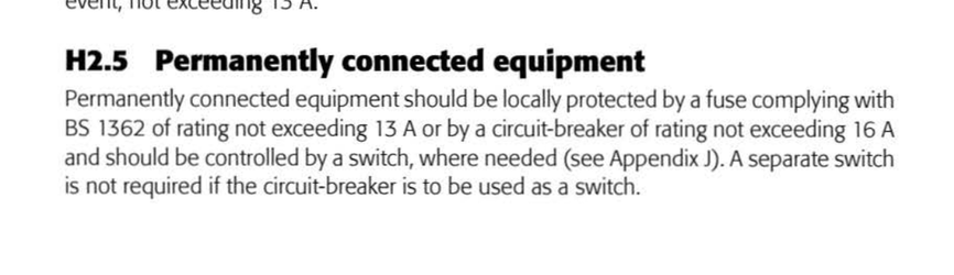

Hi Pete. The 16A breaker would be local protection rather than whole circuit protection. It would protect only the 16A socket, and the ring would be protected by the usual 32A breaker

Personally, I think a 16A socket on a ring final, locally protected by a 16A MCB may be safe, and may be compliant.
Here is a comparison of the time/current characteristics for a 13A BS1362 fuse vs. a 16A BS60898 MCB. Appologies for the poor quality of the image, but hopefully you can see that for most of the curve, the 16A breaker opens quicker for the same overcurrent.

"16Amp socket from a rfc protected by a 16 Amp breakerWas what was said Mate
Interesting. So the installation I saw with a Wylex switch on the ring with a 16A fuse to a commercial socket outlet appears to fall in line with the regs, at least in part. Although, would a 16A commercial socket/plug comply or would it have to be permanently connected.
It looks like the rule of thumb that not higher that 13A off a ring is not true.
I would stop short of saying a 16A fuse definitely complied, but I couldn't say that it didn't comply either. The 16A breaker is mentioned in the OSG (in the 17th edition too, so it's not a new thing), being an IET publication we can assume it carries some weight.
The actual regulations concerning ring finals are surprisingly sparse. The design guide in app 15 will ensure compliance, but is not actual regulation, and deviation from it doesn't automatically mean non compliance.
A double socket is designed to run at 20A, so yes, it is expected that a load of greater than 13A will be placed at a point on the ring for at least some of the time.

That indicates it does comply, but the appliance has to be permanently connected, not via a disconnecting device of any sort (a socket that is commercial or domestic). The picture you posted in your first post does state so.

So, as been gleened so far:
1) A 32A ring can have a 16A appliance off it, with the appliance:
a) only being fixed;
b) with an isolation switch;
c) with a 16A fuse.
2) A 16A radial can have a 16A appliance off it with a fixed appliance or off a 16A commercial socket (the only 16A sockets available in the UK).
3) A 32A ring can be re assigned to 16A ring by a mere change of an mcb/rcbo. The appliance can be fixed or with a 16A commercial socket. As per the 16A radial.
Any constructive comments?
I would not connect a 16A load to a 16A general-purpose domestic socket-outlet circuit. When the 16A load is in operation at full current there is zero remaining capacity for other appliances, and when it drops back in duty-cycle there might be only a few amps. Since one would expect at least some load on such a circuit, small overloads might occur frequently that probably would not trip the MCB. This is an unsatisfactory situation that should be avoided to prevent premature failure.
There is no need to protect the circuit at 16A if the cables are installed with an Iz>20A which is a requirement of them being suitable for a 32A ring. Therefore it could be protected at 20A. Personally, I would rather it be protected at 32A.
c) with a 16A fuse.
Without meaning to come over as pedantic, it specifically states a 13A fuse or 16A MCB.
Note, I am not endorsing this as a 'good idea' (tm). There is a recommendation to connect loads of this size to dedicated circuits, which I think is sensible. But it does seem that a permanently-installed load that can operate correctly from a B16, that probably has a long-term cyclic consumption of less than 13A, may be connected to a 32A RFC if overall expected loading permits. As above, I don't like the 16A OCPD option.

So, a 13A fuse or a 16A mcb
