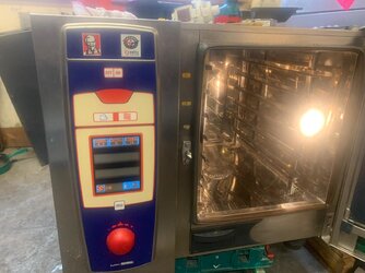

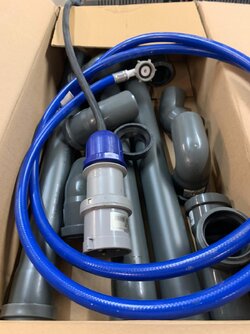

In a small restaurant theres a single phase supply just wondering what size converter i would need to convert 3 phase to single phase and what size mcb to install into the ccu
thanks[ElectriciansForums.net] 4.8kw electrical combi oven/steamer 3 phase
What size single phase supply is there into the restaurant and what's the total load of all the other equipment?
How many pins thas that Blue plug got that's on the oven?
That's a single phase plug. Do you have a picture of the oven rating plate?
Hi There should be a data plate on the left hand side if you post a picture of that i can check its requirements for you as I am a Commercial Catering Equipment engineer authorised by the manufacturer of these units
