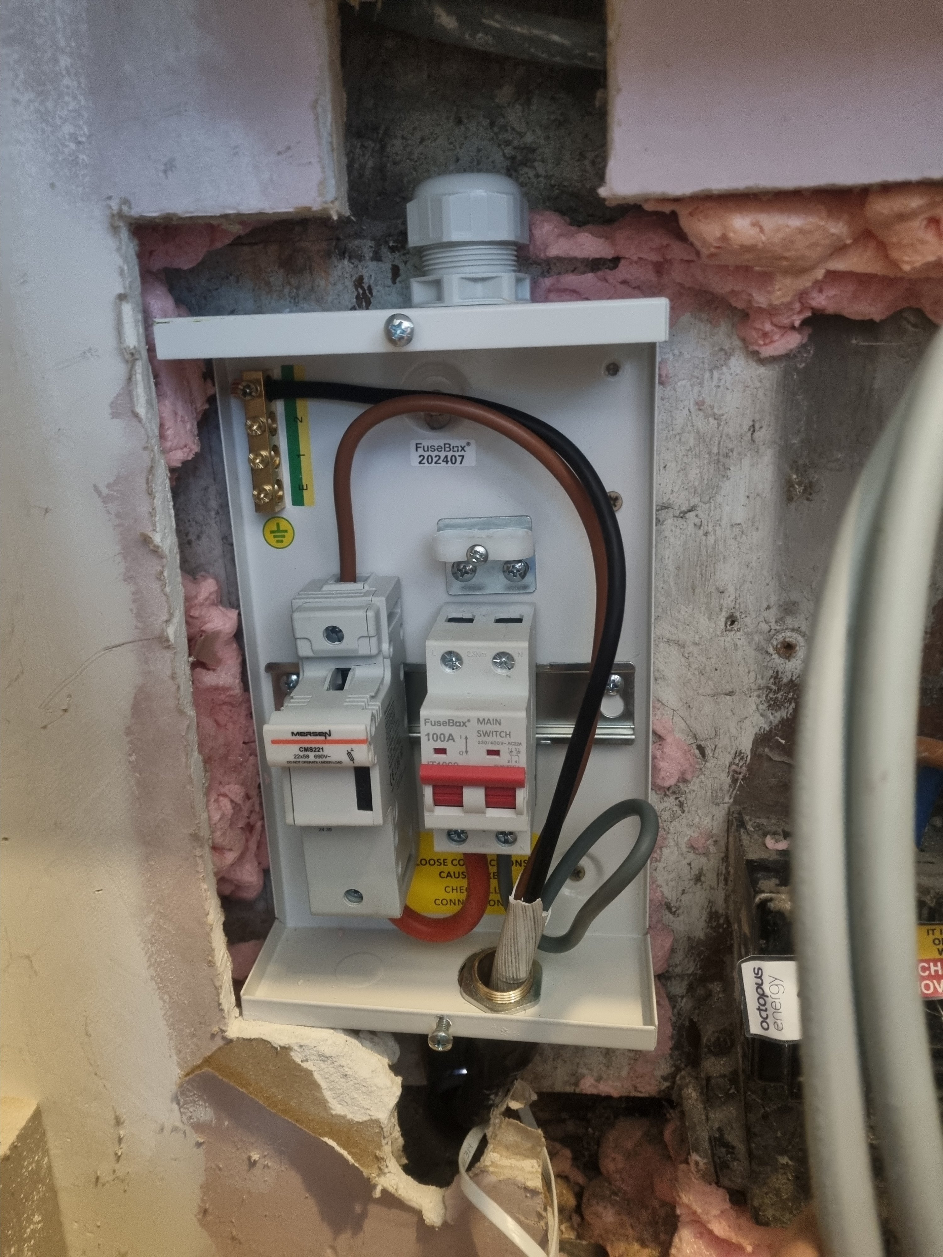

The “real world problem” is as I described.
The white inner sheath is not classed as being enough mechanical protection for just floating around in free air. It’s more just a bedding to keep the actual cores together.
The galv box, then flexi conduit is a valid solution… or move the sw/fuse to accommodate taking the gland directly.
Probably get the odd red 'X' for this, what what I would do, and did on one occasion, where there was little practical option, is to fit a galvanised adaptable box onto the SWA gland, fit a large stuffing gland to the box as well, slide off the outer sheath from some 25mm tails, and slide these over the L and N to the CU, trapping them in the gland.
I would do something similar, however, all you need is a 25mm bush instead of the adaptable box, then use some flexible conduit to protect the cores.
The supply end will be earthed. I just havent done it yet as I paused to ask for some advice.
I can see why the white sheath ideally should be covered but in truth, in this instance, cannot see how that may be achieved nor what real world proplem it would cause as it is.
It's NOT a sheath. It's simply bedding. It cannot be exposed.
Yes I well understand that, sheath, bedding, scemantics on word useage.
In any case. I got the SDS and chisel out. adjusted the blockwork to make room for the SWA to bend. Im not 100% happy with it, it has pulled the fuse switch box out of square, but the cover still fits. Just need to pull it out and drill for the earth cable.

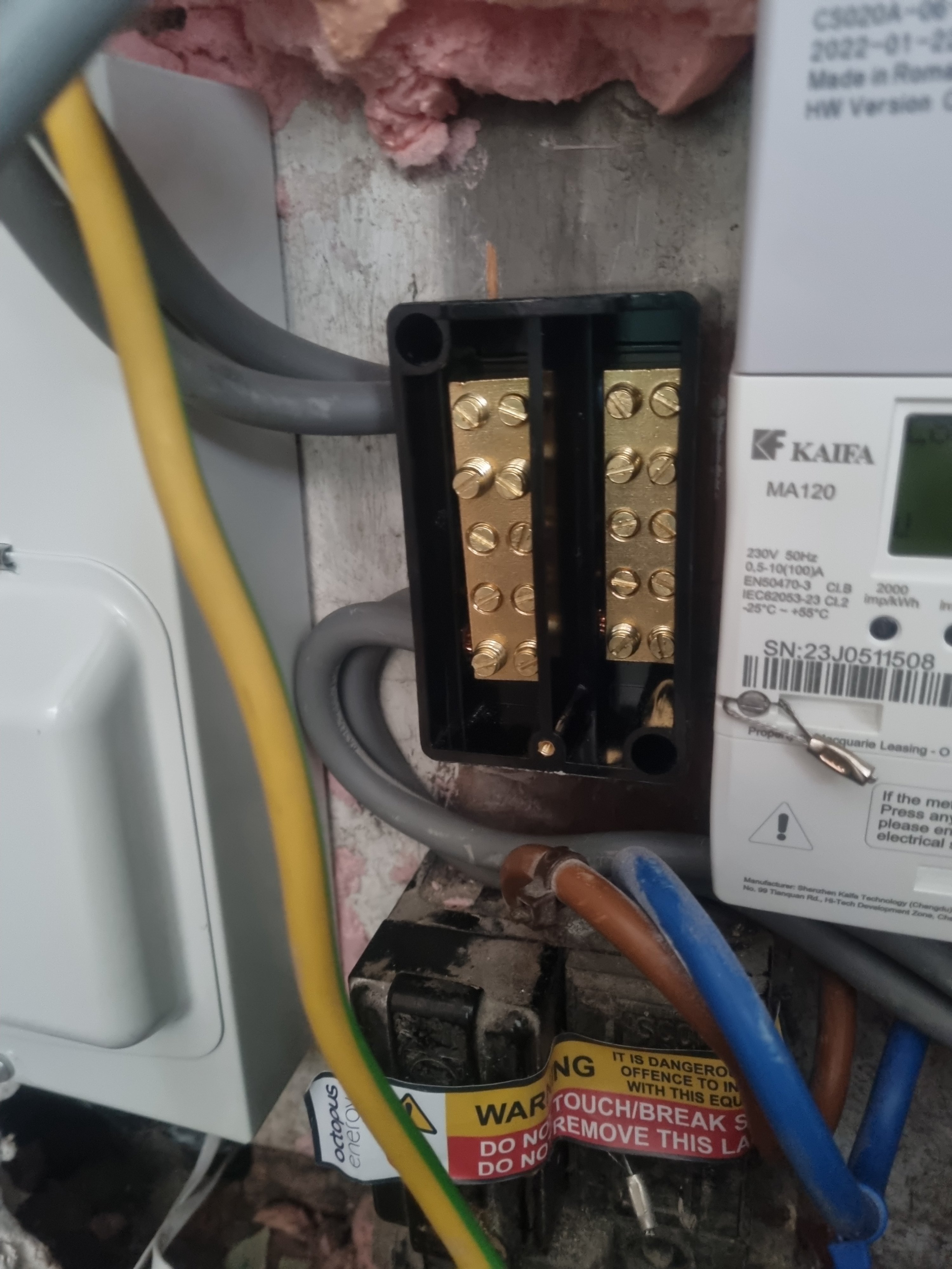

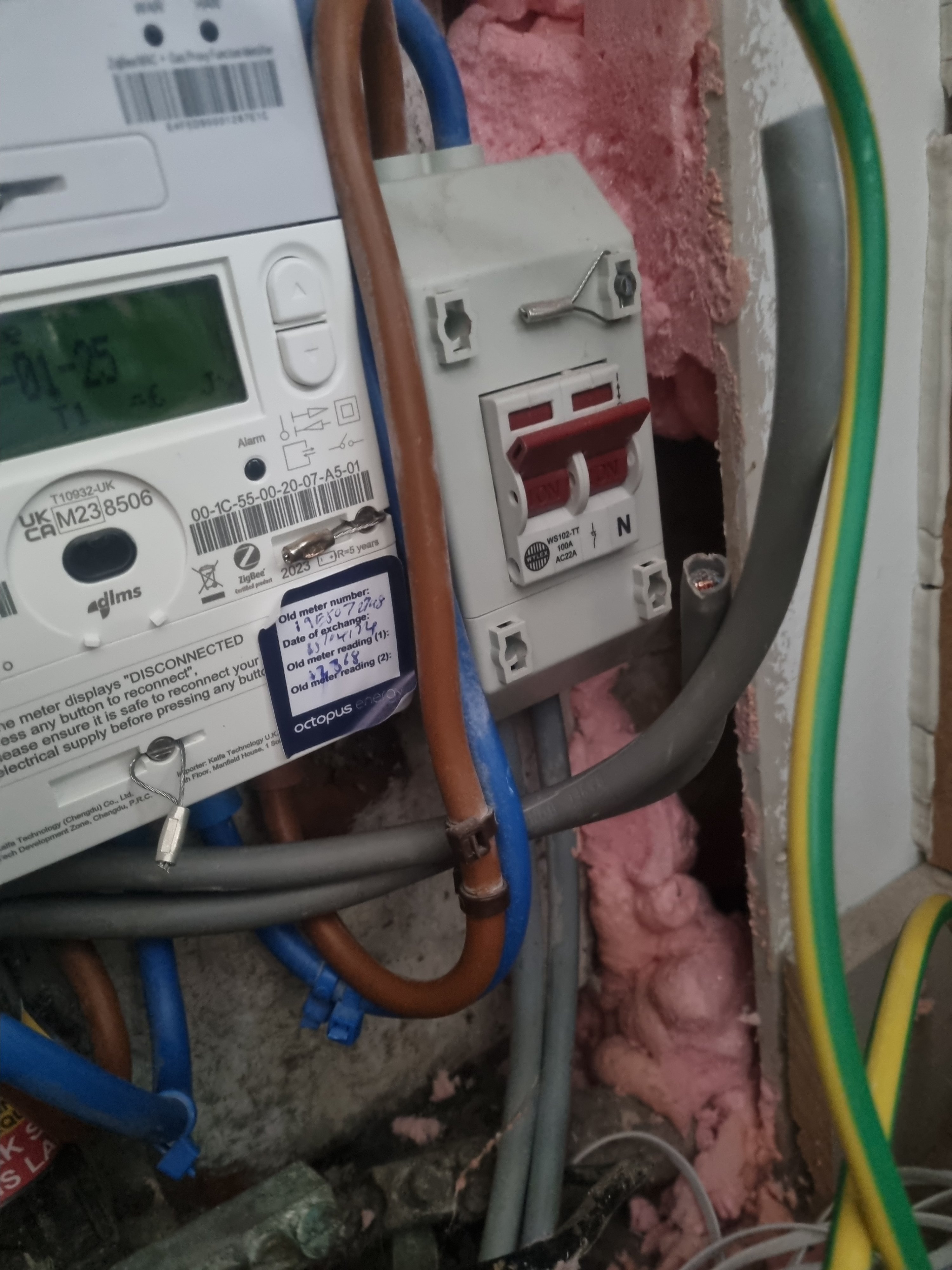

All done, just need to rake the tails out of the isolator and put them into the henley, and put the extra tails I ran into the isolator when I am ready to connect to supply. Oh and mark with coloured cable ties. Two full days to get to this point. What a faff.

Sleeved the black in green/yellow, yes?
And you put the lid back on the Henley block before turning on the isolator? (After dead testing)
;) :confused:
;) :confused:
No I thought pink and orange might be nicer, and who needs lids?
Black is marked with green and yellow tape as have no green yellow sleeve the right size. Grey is marked with blue sleeve. And yes, of course the henley will have a lid before the circuit goes live, its left off for now as I need to be back in there.
Im just pointing out some safe practices.....
but to me, the henley block cover is off, and the service isolator to the right of the meter is turned on....
Maybe the photos were taken at different times....
Its very hard to give full context with pics.
The henley is not connected to supply, described that in the text. The tails for the henley to split the supply are there in front of the isolator, perhaps my description wasn't the best worded. But the supply to the switched fuse is not yet connected, that will be connected when I'm ready for supply and testing in the workshop.
So what is connected to the henley just now? 2 sets of tails...?
Im sorry for pushing it... but like you say, hard to tell with just pictures..... maybe a wider angle showing everything.
One set goes to the new fuse switch, one set will go to the output of the isolator output (you can see the ends hanging in front of the isolator in the pic ready to be put in) and the current tails on the output of the isolator will get moved to the henley. So the supply will go to, and split, at the henley, one set to the existing CU, one set to the fused switch, when finished.
Right now, the supply is untouched and the henley is dead, as it is not connected to supply yet.
This is easy peazzy stuff, gland SWA using a correct SWA gland into a metal conduit box. Leave the tails long. Connect earth/ground wire to conduit box so you now have 3 tails. Connect from conduit box by bush and couplers or flexible conduit to your breaker box. Run the tails through the connection into the breaker. Have the installation checked and tested by a qualified electrician ( having your 18th does not make you a sparks just like passing your theory test does not give you a full driving license )
Yea, it is easy peasy in principle. The issue was with the very tight space and bend radius, as discussed, and the question of the bedding being acceptable to leave exposed in a locked cupboard.
Yes I know having 18th Ed and Part P does not make me a sparks, I didn't pretend to be one. I mentioned it to indicate that I know the domestic regs - my background is related though.
It was more a question of common practice, best practice, and possible ways around the issue in front of me. The issue is, however, resolved now after I clearanced the interior wall with a small concrete breaker and managed to get the radius required to terminate into the fused switch on the gland, which is what I had intended in the first place before running into clearance issues.
My plan B was exactly as you suggested and I had a box, but getting the box to clamp up to the fused switch was proving problematic again owed to clearance. Appreciate the confirmation my plan B was acceltable too, thank you.
That’s what holesaws were invented for.
If the knockout isn’t the right size, or in the right place, then drill your own hole.
Could you bush a metallic adaptable box to the bottom of the sw/fuse to give some sideways options of entry?
Hello folks
Inhave my 18th Edition and Part P l, but I dont trade as a sparks.
I have a question about best practice for terminating SWA.
I am currently installing a connection to my new workshop. (I used to be STROMA registered years back, will likely reregister to sign off myself).
16mm 3 core SWA is already run in ducting underground, correctly trenched in. The run is 10m end to end on the SWA.
I am not using the armour as the CPC.
The workshop end is glanded straight intl the CU, and wil be earthed.
The supply end will go from the meter to a 2 pole isolator on 25mm tails, into a henley block, where it will split to my existing domestic CU and into a 60A fused switch, still on 25mm tails.
The fused switch does not have the correct knock outs for the SWA, and it is to tight anyway to bend the SWA into it.
At the moment the SWA is gland sits in the brick wall, and the three conductors go in the mechanical proeltection white sheath, through a plastic cable gland into the switched fuse. The house end gland on the SWA will also be earthed, despite not strictly being required. All the house end stuff is inside a meter cupboard.
Is it acceptable to leave the SWA gland sat like this?
The bends will be too tight if I try to force the SWA round to a box. I did think about putting a steel plate on the wall and mounting the gland to that?
Photos attached, not.finished yet as the earths are not in place, and neither is the henley block, cable clips etc but you can see what I mean. Note that the existing CU is not my work, neither is all.the builders foam etc. All I have added is the small workshop CU and the fused switch.
Advice, thoughts, and constructive criticism are welcome.
