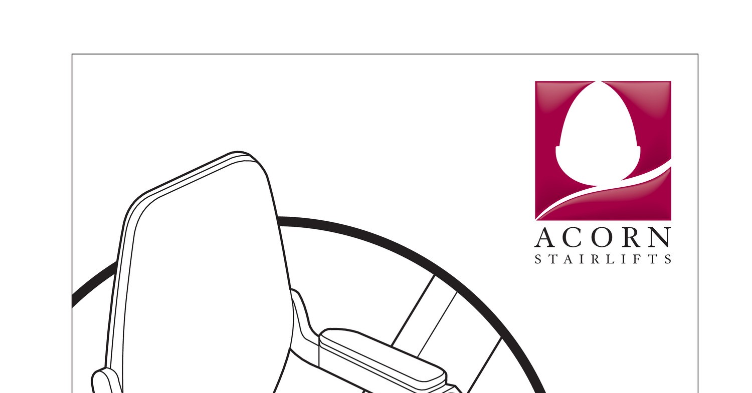

hi i have found a service manual . but for an older model, tks ...will try to manage this, this week end and come back
installation acorn guide for the 180 here
file:///C:/Users/franc/Downloads/Acorn_180_service_Manual.pdf
