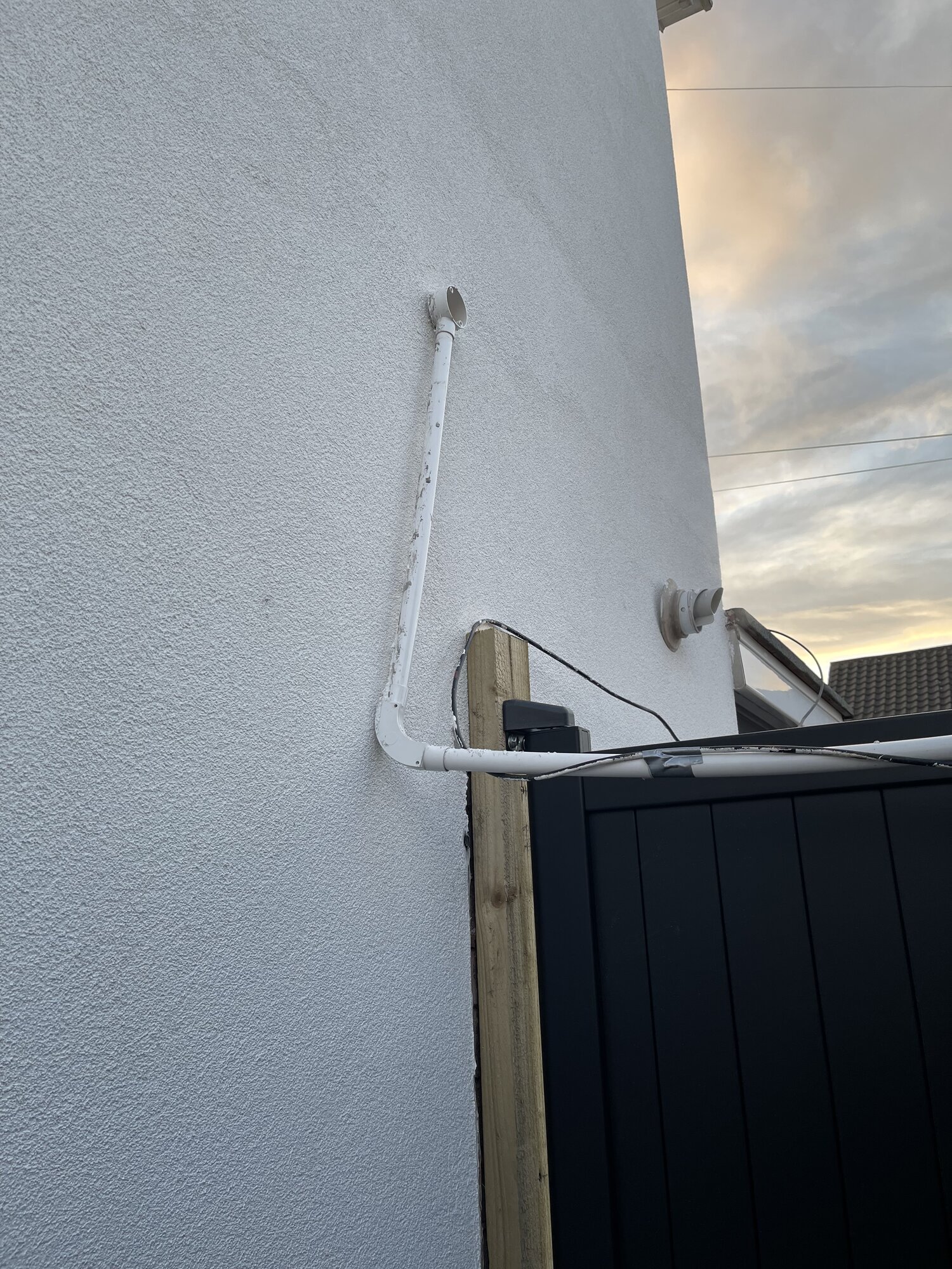

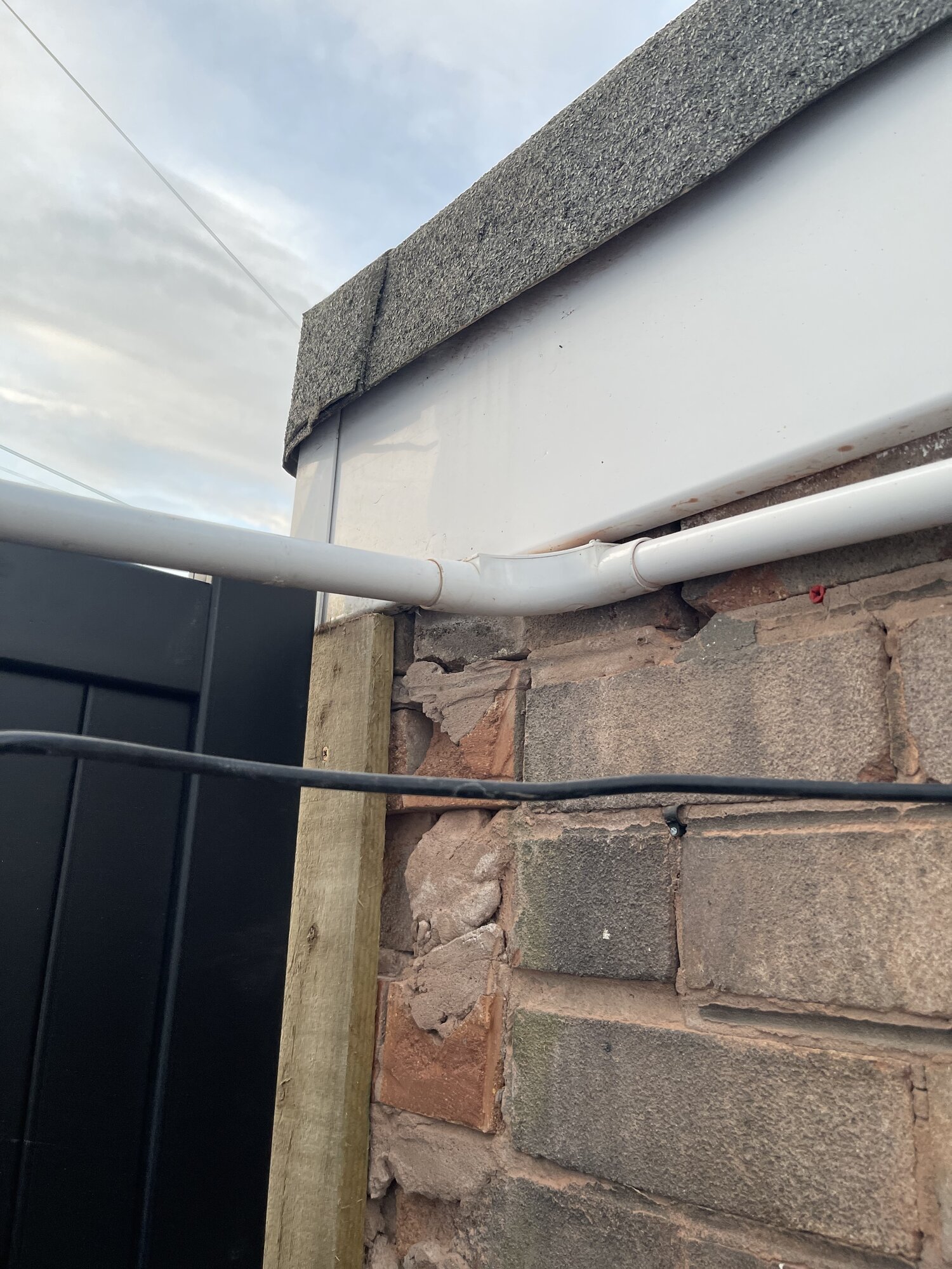

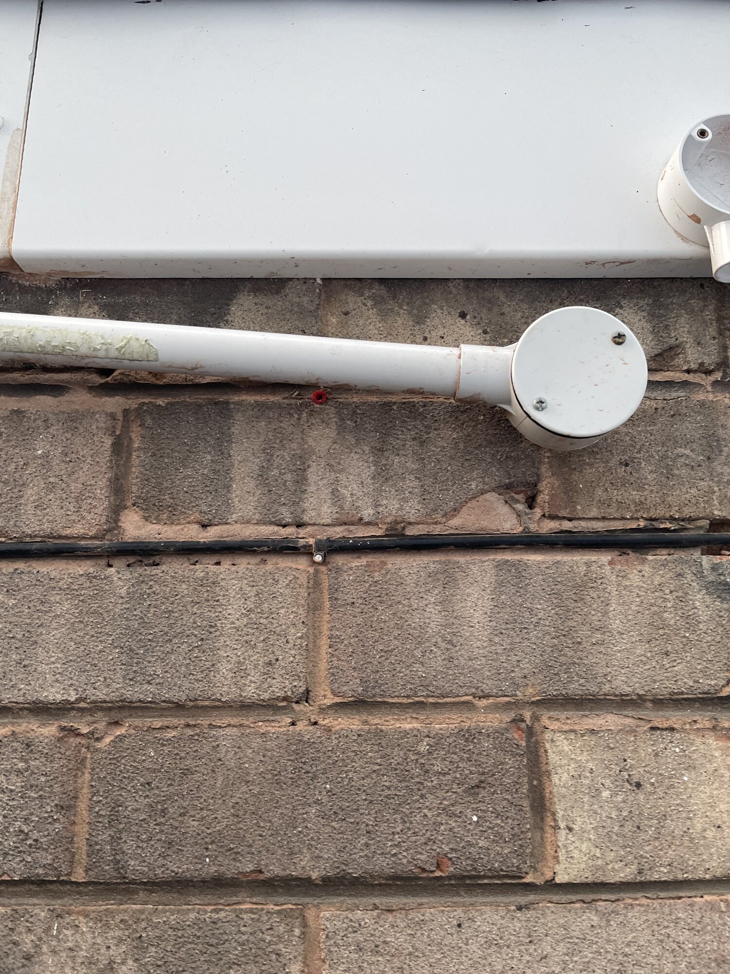

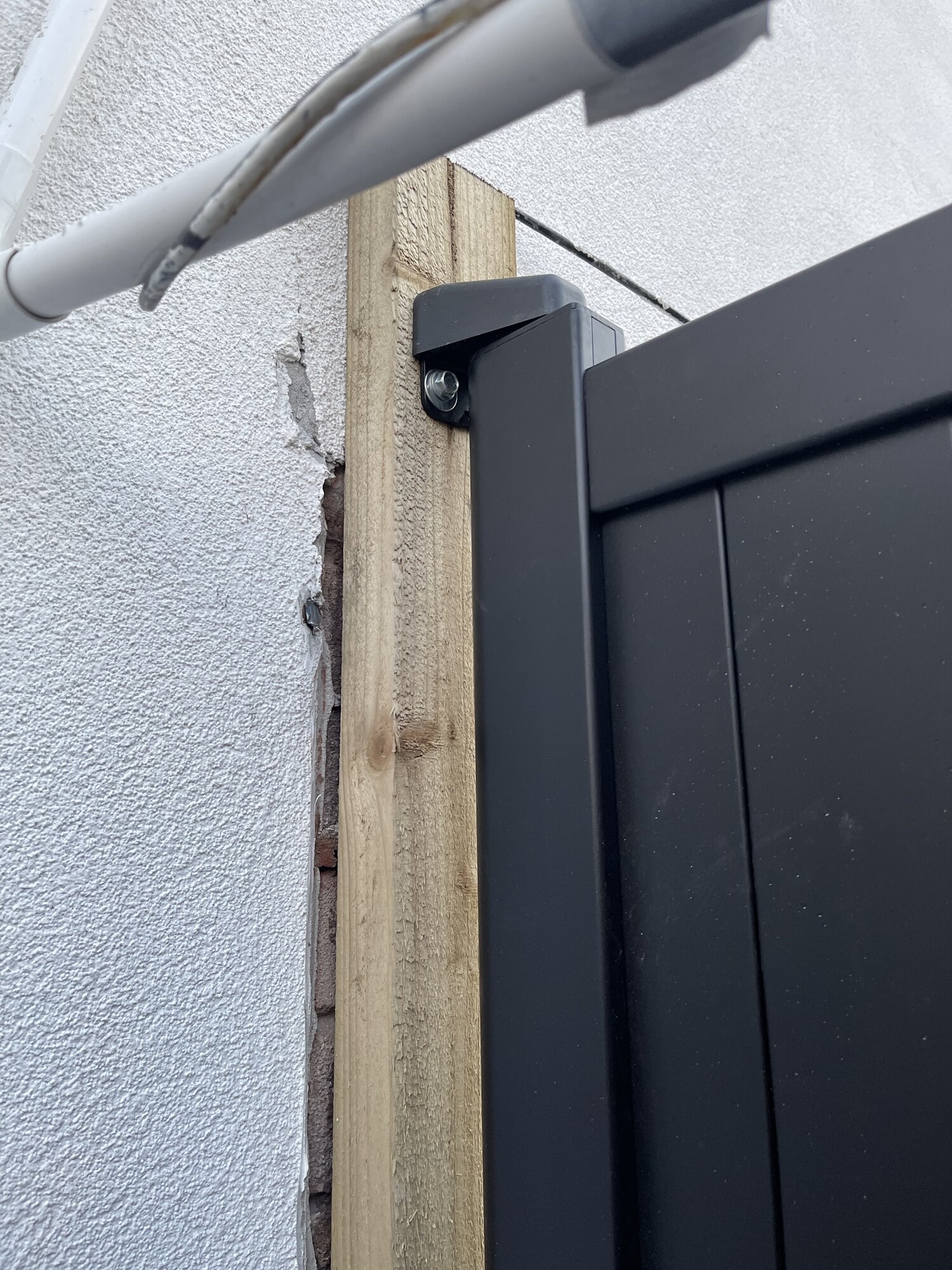

I’m looking to fix a previous install. After having some rendering I have a feed that’s in 10mm T&E and I’m looking to replace the conduit. The gate is being replaced. I’m just looking for an adaptable box that I can have conduit come out the front.
I’ve decided to have the conduit come out from a Wiska box go down the side of the house and then across the gate with a length of conduit into another Wiska box and then another length into an Adaptable Box and go into the rear into the Garage and into the sub main board.
Any help or advice would be great.

If you are planning running plastic conduit unsupported across the gateway, as it is now, then, as it does now, it will sag.
Dome covers on conduit boxes solves the original question, but not the problem.
You change it externally at an adaptable box on the wall.
That's what I had in mind, yes.
Depending on aesthetics of new gate, catenary wire would get it safely across, cleat to outside of garage, then into another box to terminate and revert to T+E.
If it were my house I'd lift the paving and get it underground and out of the way even if I needed to mix some mortar and sort out the paving afterwards.
Anyway, best of luck with it however you do it.

I wouldn’t want to start lifting pavement. The catenary wire sounds good. Could I use conduit going across then metal cable tie it so the conduit is supported?
As the underground option has been knocked back I think I would just drop a unistrut across the gap to the gate post / garage buttress and stick an swa in, it would certainly look a lot neater
That’s a good idea. How can I change it from 10mm T&E to SWA. I can’t remove the T&E?
I agree unistrut across to the garage behind where the new gate is going totaly separate from it then it will not need disturbing next time the gate needs changing.
I would go swa out of an adaptable box house side and back into another the garage side unless I could go straight into the sub con unit!
You could even make an upstand from the strut if you needed more height and bolt it to the garage wall.
Sy
Gland the SWA to adaptable box, and use terminal block / crimps inside the adaptable box to join each conductor to the T&E.
You need the armour of the SWA earthed.
Sy
That sounds okay I will have a look at that.
Okay could I use an alternative to SWA as I’ve not used it before.
