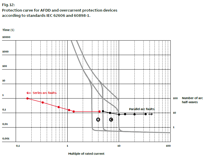

Are you sure he tested it correctly to standards IEC 62606 and 60898-1?
I showed this vid to one of the guys at work. We couldn't find the spec for the Eton on but we looked at a ABB one.
He was testing on a 40W load. That's 0.17A on a 16A device.
The ABB graph doesn't even go down that far. It just goes to 0.1 (which is 1.6A. 10th of 16A) and it is looking for an ark of 1 second at about 2.5A, so could be up to 10 seconds for 0.17A assuming the graph continues up.
http://search.abb.com/library/Downl...guageCode=en&DocumentPartId=PDF&Action=Launch
Yes but I think he was trying to say that the small spark he WAS creating might be enough to start a fire. Might.......obviously the more juice you have the more likely you are going to get a decent spark, but these days you often are not going to be using much, especially on lighting circuits. So is it worth it?
I understand where you are coming from mate, but it looks like the people who wrote the standards for these devices don't think that these small sparks are significant enough to cause a fire, as if they did then the AFDD's would be designed to detect them.

You can basically ignore the tests done on the vid as they are flawed.
It's disappointing really, as when you look at it, it looks like John Ward did not actually read the spec before doing the test. If he did then he knew his test would never trip the AFDD.
