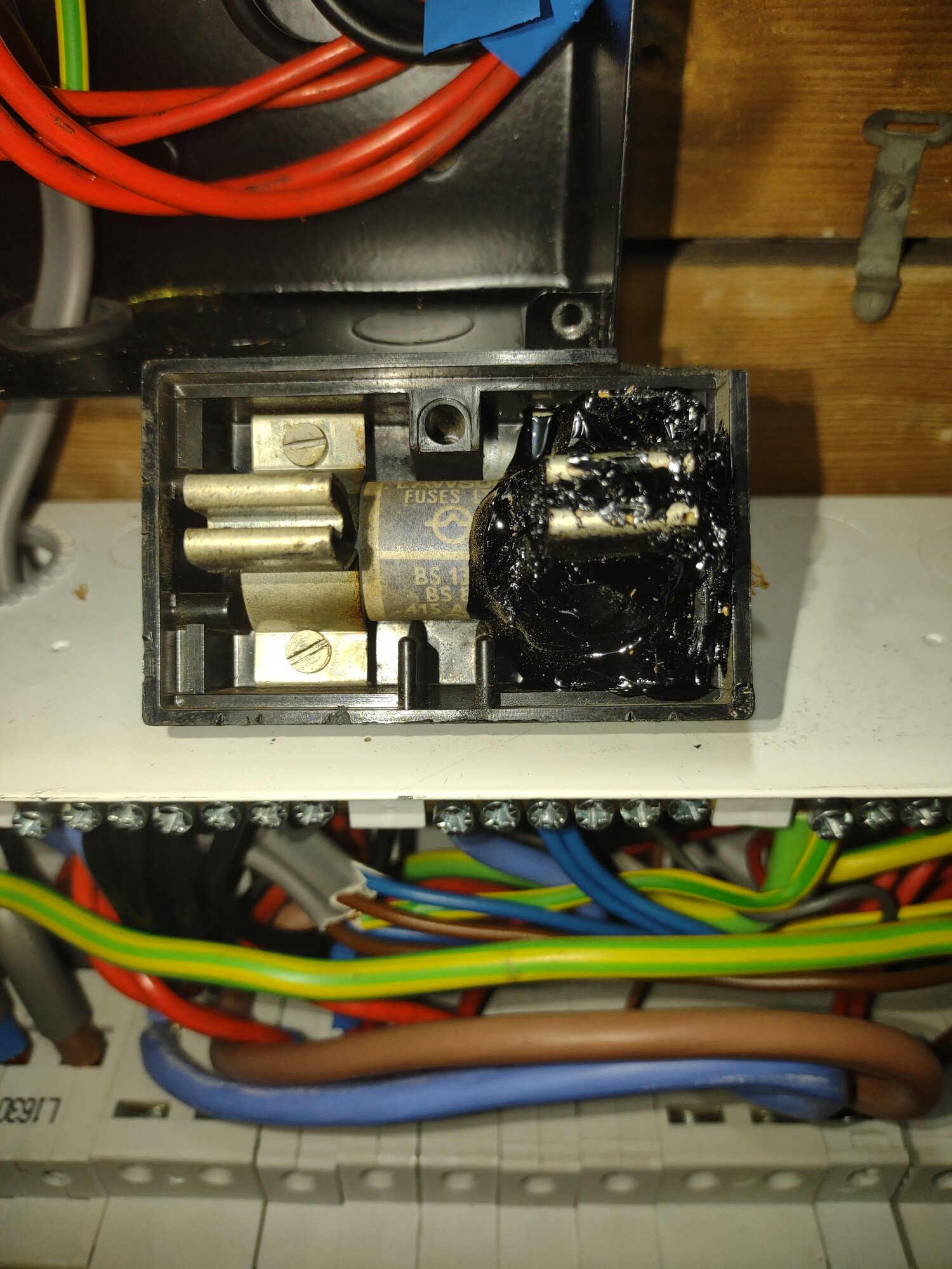

And nothing protects against THIS!
Big shout out to SPN who were brilliant yesterday. Onsite in under 90 minutes. Fixed in 30 more.

Wouldn't any downstream AFDD that was loaded detect this and switch off. The current passing through the AFDD will be varying with an arc's signature whether the arc is before or after it.
If all loads were AFDD protected, the current through the cut out would fall to zero and the resistive heating would stop.
That assumes it was arcing, and not just a few tens of mOhm resistance heating.
Yes. And not even a few tens of ohms is required. A half ohm (poorly tightened main fuse) will produce 30 Watts of heat in a fuse enclosure under full load. . Added to the heat produced by the fuse under normal working circumstances.
I was talking of milli-ohms.
Say 50A (shower and/or cooker) & 0.05 ohm = 125W
