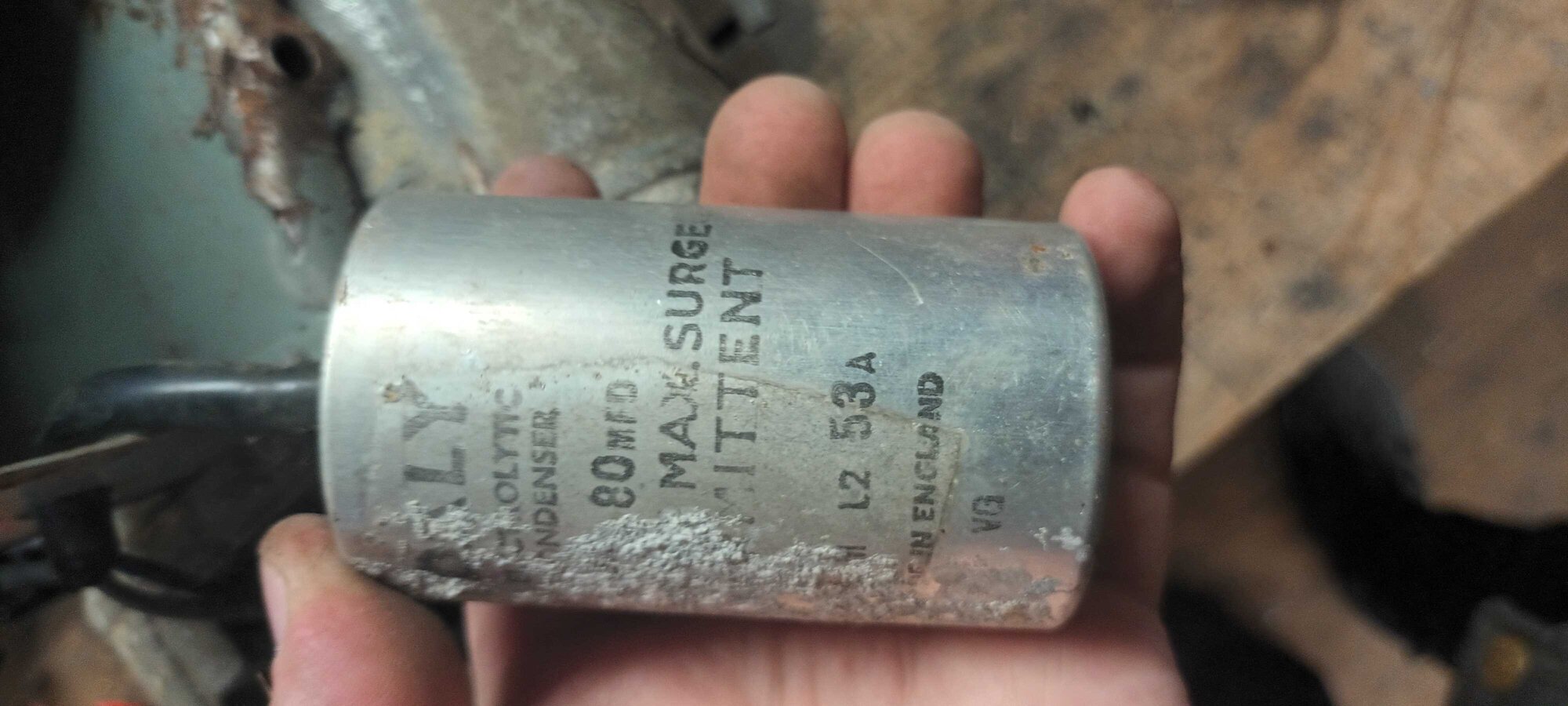

The capacitor has been laid against some cardboard inside the casing for quite some time and some of the markings are illegible
[ElectriciansForums.net] Antique motor wiring

As well as testing the insulation at 250v as Mr Howard recommended I'd also suggest you don't connect that old capacitor anywhere near a supply voltage. Those old capacitors didn't age well so just replace it now as a matter of course.

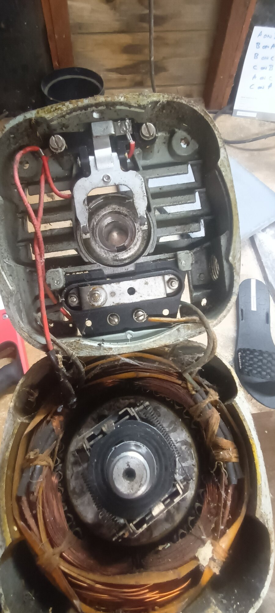

See attached image of the inside of the motor

Any idea what rating the replacement capacitor should be?
Right, so centrifugal switch, two coils, and a start capacitor (google 80 micro farad start capacitor)
There are lots of diagrams online showing you how a single phase motor with start cap and centrifugal switch is wired up.

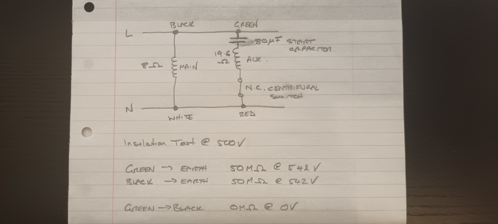

See wiring diagram I think is correct with insulation test results and better resistance readings
When I tested the Green to Black connections I made sure they were not wired together at the back of the motor.
There is a push reset button on the back of the motor that is a normally open switch which closes temporarily when pushed and opens on release. Where does this fit in to the wiring above?
Also on checking various websites I get a range of differing capacitor values to use ranging from 2mF to 40mF. I have no idea which to use.
I am assuming that something rated above 350V is okay to use

Just thinking about this last night my diagram was slightly wrong, the green comes from the winding and not the capacitor.
Would the reset button be wired in parallel to the capacitor as in the following diagram?

In no particular order ...
I'm no expert, so can't comment on whether you have the run and start windings correct. My gut feeling is that the start winding would have the lower resistance so as to pull more current and give a better starting torque, but I could be completely wrong there.
Otherwise looks OK (your first diagram).
No, the reset button wouldn't be wired there - no idea what it would do if it is indeed a N/O switch.
You set the direction of rotation by swapping ends on either winding. I.e. swap red & green OR swap black & white.
Are you sure the reset button isn't an overload device that's gone faulty ? I'm thinking that if it's an overload device, but the latch has failed, then it might look like a N/O switch. Perhaps that's why the motor was ditched ? If my guess is correct, it would be wired between the supply live and the motor internals.

For the windings I read somewhere that the main winding was the thickest wire and the auxiliary was the thinner. But I could be very wrong.

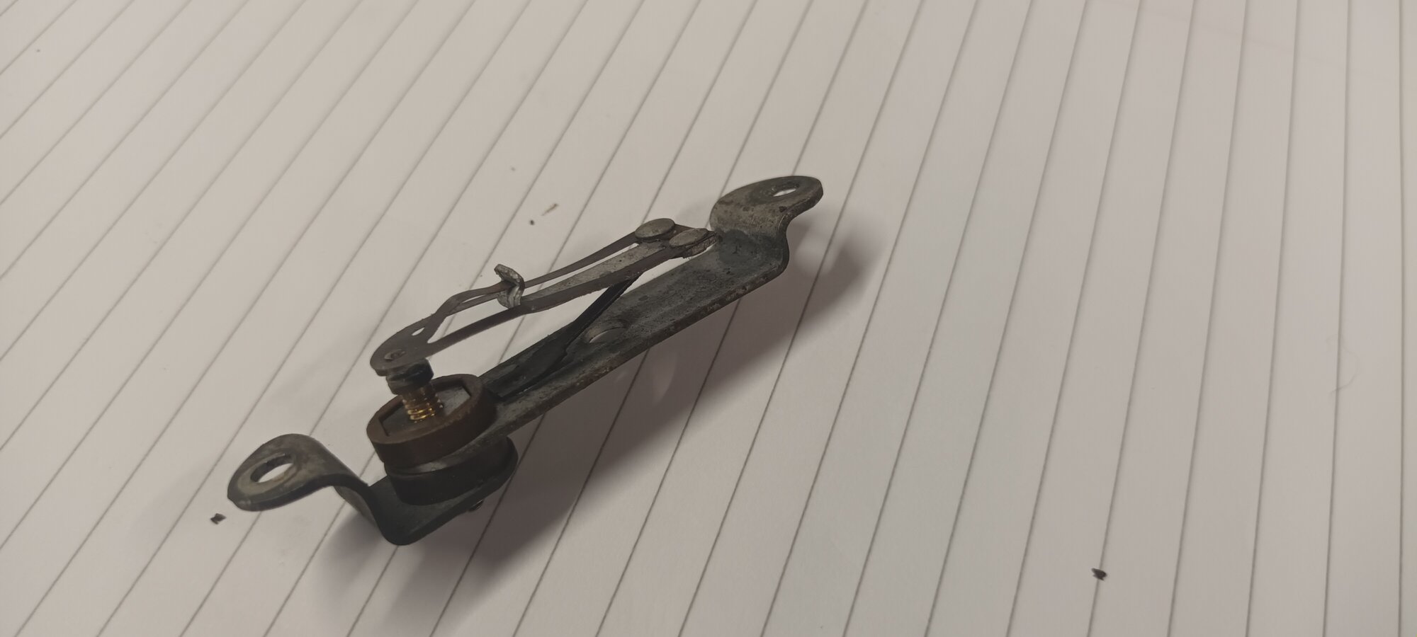

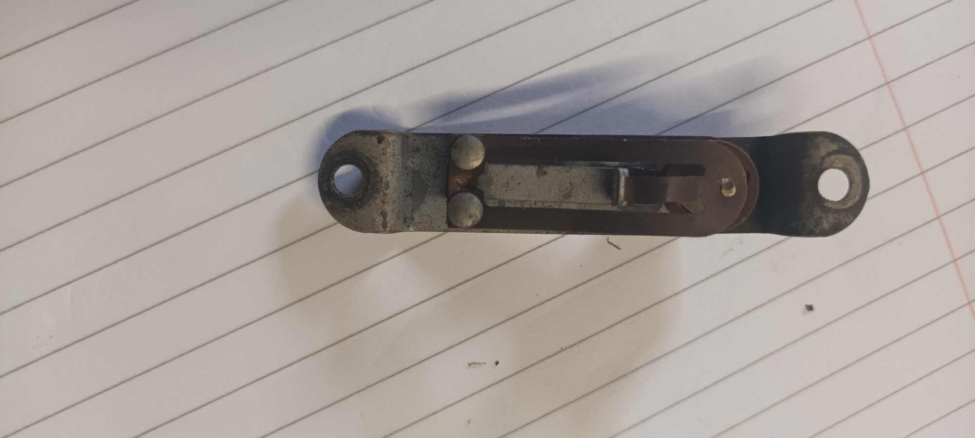

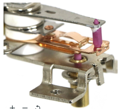

Here are some images of the switch
External view
Internal View with adjustable screw to adjust the distance of the connecting metal parts

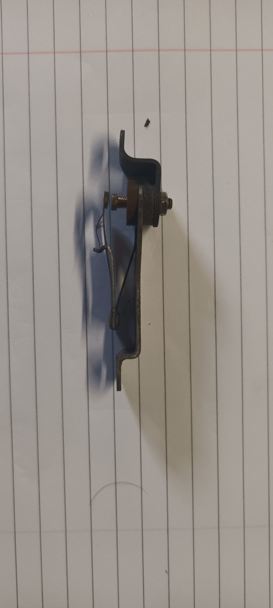

Removed switch
It should be adjusted such that it "snaps" open at a certain temperature. When cooled down, pressing the button should then make it snap back again.
It needs to be wired in series with the supply so it cuts off the power if tripped.
The manual "Press to reset" function is essential to avoid it starting up again when the motor cools down. Depending on what it's driving, automatic restart could be very dangerous.
I would expect there to be pressure applied to some part of that cutout for it to snap open and closed correctly. It looks to me like it is already in the 'on' position but the contact is open due to something not pushing on a certain part of it from the other side. Is it pushed in by something in the plastic housing? I've attached a photo of a thermostat that shows pressure being applied to 2 points in the mechanism (the 2 purple insulating pieces). The bi-metallic strip is the bar of metal at the top of this photo. as it gets hot it bends down pushing the copper contact piece in the middle down past the centre point and the lower contact on the left suddenly moves down away from the fixed silver upper contact. The lower pushing piece is adjustable up and down to set the switching temperature. The further down it is the more the bi-metallic strip will have to bend to push the copper strip past the centre point to switch it off.
Without the second pressure point the switch will just slowly move causing severe arcing. I wouldn't adjust anything to make the contacts close at this stage.
