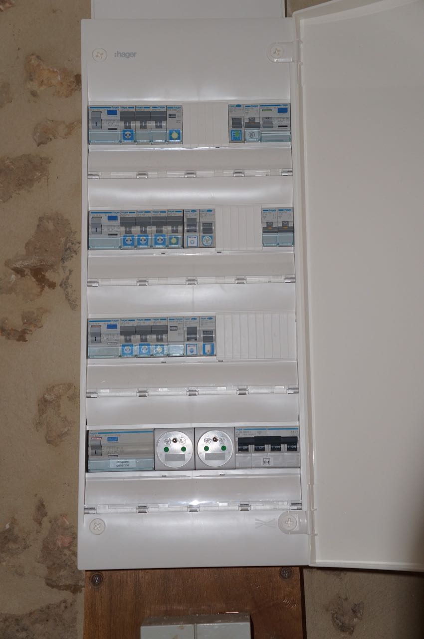

hi all I’m just wondering are the forum members moving away from doing ring circuits and doing radials instead ? I have been reading that this may be the way industry is going wether this is to aid in the introduction of AFDDs I don’t know , obviously AFDDs won’t work in rings, that’s why I recon radials will have to be standard before AFDDs are used.
There will no doughy be some sparks who install AFDDs on rings which will defeat the purpose of them , ( if I’m right )
Should all new builds now be installing radials ??

The start of my posts on this thread was concerning the use of of DP RCD's in the EU and that rings aren't used, also note that three phase is common on domestic supplies, especially in more rural areas.
For what I have seen in the E.U. consumer units have an RCD as the main switch and D.P MCB's so if there is an N-E fault you turn off the C.B wherein the UK if we have an N-E fault you need to find the fault.
I think the point is that when you abandon the diversity of 32A socket-outlet circuits (note: 32A but not specifically rings) you end up with many more circuits because each circuit may only be able to supply one appliance. Our house had one ring serving the main living areas including the whole kitchen with washing machine, dishwasher, tumble dryer, microwave, all portable cooking appliances etc. The 30A fuse never blew in 25 years and when replaced by a 30A MCB that never tripped. It would take four or five 20A circuits to give the same flexibility.
I do like DP or perhaps better SPSN MCBs for DP isolation. Europeans were often ahead of us in these things. Old Dutch fuse boxes (of which I have a few) that use Diazed bottle fuses, have a DP isolator for each outgoing circuit as standard, so they were onto this even before MCBs.
I used to think rings would gradually be replaced by radials. My tutor for one was dead against rings. But I can't see it happening now - replacing one ring with probably several radials when each extra circuit means an extra ÂŁ200+ on an AFDD. 32A radials? Maybe, if they start making sockets with terminals that will accept two or three 6mm2 conductors!
