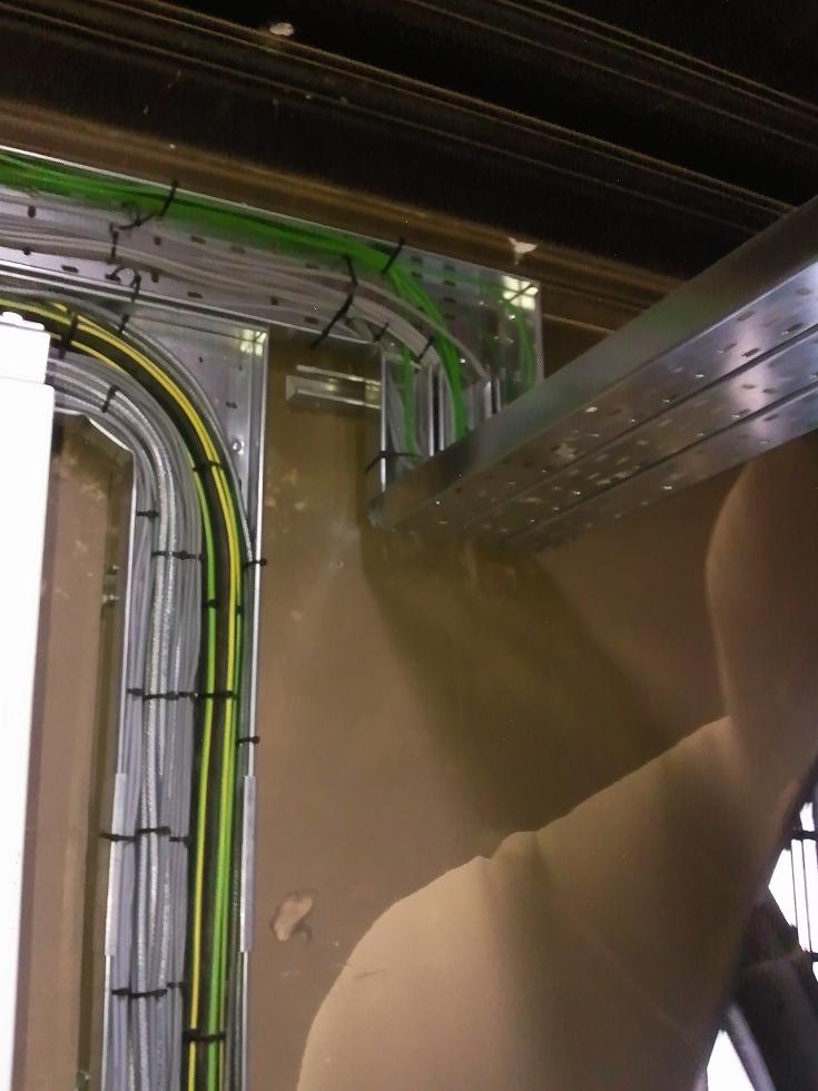

a sign of of a quality install is all metal containment with no jumps / gaps / breaks !
which also has the added benefit of not needing to fit millions of individual earth tags and provides a much superior cpc if needed.
should look like something i knocked up on my last big project.............

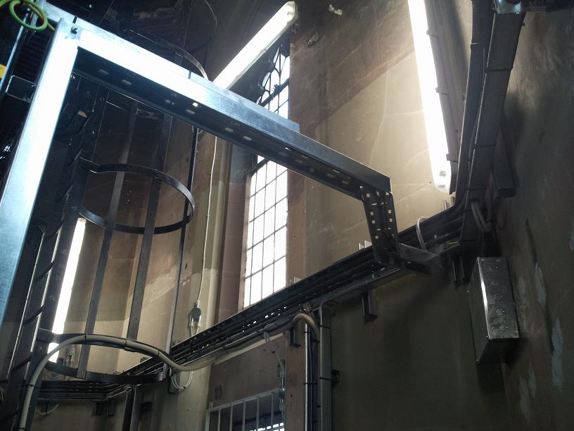

cables tied to fixed ladder-come on!
- - - Updated - - -
is the ladder earthed?
there is no ladder , its all tray.

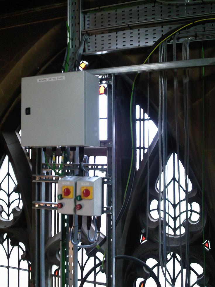

all exposed metalwork is earthed.
you still havent posted pics of your own work to show us all how its done instead you obviously prefer to hide behind a few pathetic critisizing posts.
come back when you can bring something of substance to the table.
needs more tie wraps ? lol is that all youve got ?
im not talking about ladder racking, its the personel access ladder with the cage around it,youve get cable attached to it. bad parctice!
