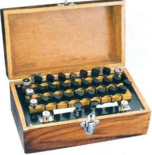

@Lucien Nunes in my vast pile of junk I'm sure I have a post-office test box. I acquired it as a curious item that looked nice and never twigged it's purpose, but this thread suddenly resulted in a light-bulb moment and I realised that all along I had a bridge in a box without realising it.
In theory, assuming I find it, would a DC multimeter work instead of a proper galvanometer?
It's a bit like this one (from memory)

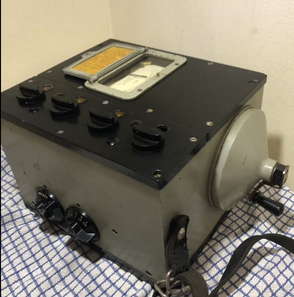

in my cave i have a bridge megger. could this help . it's finer functions are beyond my old brain these days.
Noting @pc1966 's comments earlier in this thread about the Varley test's shortcomings, yes, I recently discovered the Megger Bridge series were designed to conduct Varley and sometimes Murray tests. Is it either of these:

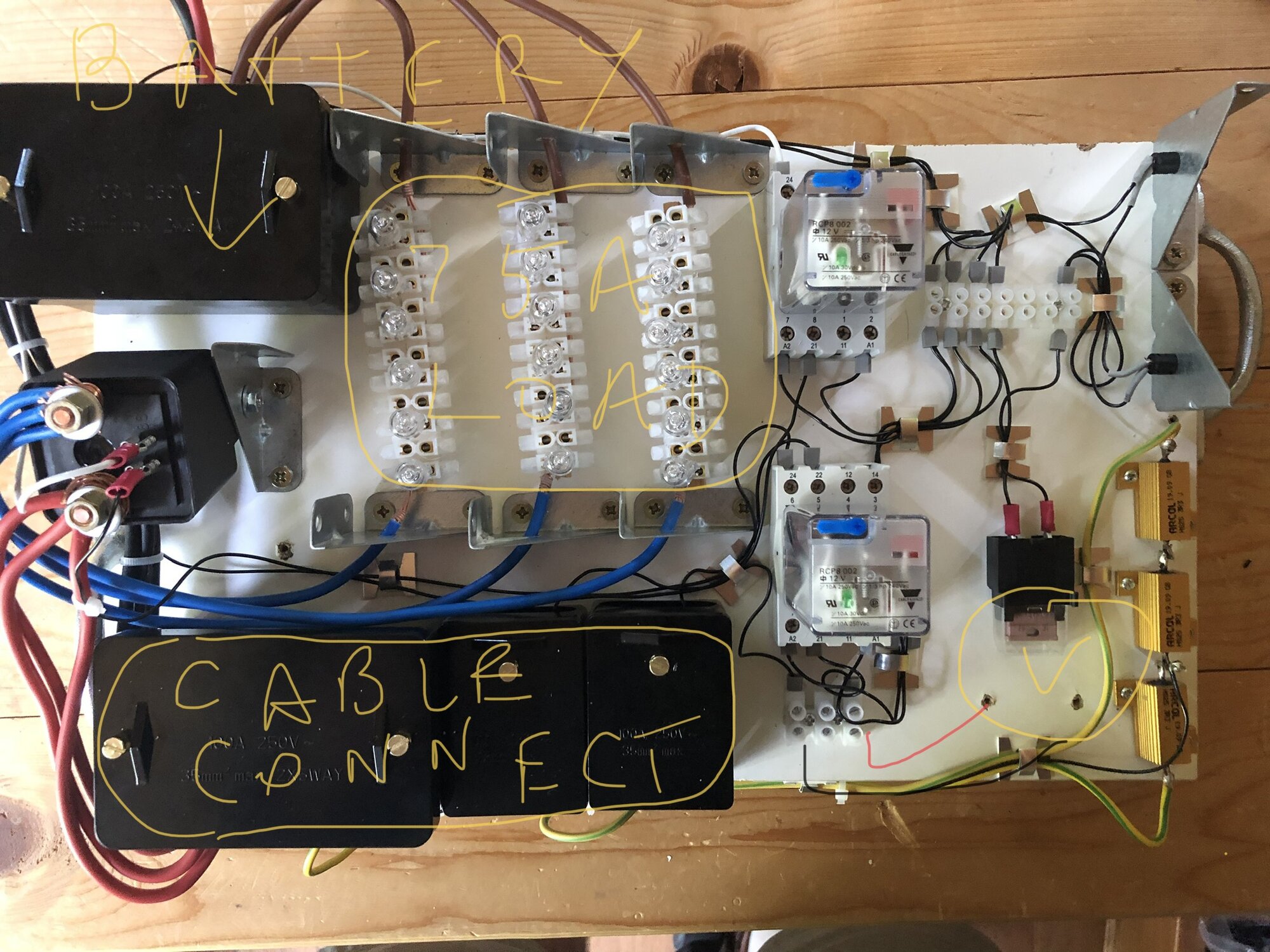

freddo: Do you have a preferred first test on the cable? If you do I will jot down a test schedule including how to connect 'what to what'. Otherwise I will decide.
Do you think 5ish seconds for one voltage measurement immediately followed by 5ish seconds for another will give you enough time to read your dvm and then record the values?
Looking at my little video clip I am minded to allow 5ish seconds for the current to settle before the voltage measurements are taken.
The test routine would be: Press a button - wait 5 seconds - in the next 5 seconds interval take a voltage reading - and then in the final 5 seconds interval take a second voltage measurement.
In practice - press a button - watch the dvm until it is settled - record the value - and then when you hear the click of a relay operate wait until the dvm is again settled - record the value.
xame as the 2nd pic.
Yeah, that one does the Varley test. Don't know if yours still has this plate on it (from an ebay picture):
From what I gather, when in Bridge mode it measures resistance between EARTH and LINE, you crank the handle and adjust the ratio and the 4 digit values - I think the needle at infinity position shows you have it right. (I'm not sure how it indicates higher or lower, other models use a galvanometer and the needle moves both ways to show.) Then repeat with Varley position which measures between Earth and Varley terminals and do the maths shown.
No preferred test. Yes those times sound practical.
Test rig completed. The 3 gold test resistors are so freddo can check the rig works on arrival. The I button pulses the test current and the near/far button switches the voltmeter between near and far ends of cable.
