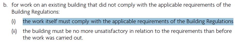

No one seems to have mentioned that you should not be putting sockets striaght on top of the skirtings anyway. All sockets and switches etc should be installed at a height of between 450-1200mm.
On a rewire? Really?
Mate, you're in a hole. Stop digging
Yes really. The problem is people like to pick and choose the regs they follow. This is not only a elec reg but a building reg also. I know it is never followed domestically this is why the domestic sparks out there are not thought of to well in the commercial world. It is as clear as daybthat if you put socket outbof that range you are not installing to the regs. Agreed? If you disagree please quote a reg to me.
It's a rewire, so the sockets and switches shouldn't be installed at a height worse than the original state.
I am sorry but that is madness. 'Well it was a 2.5mm main earth bond before I re-wired so as long as we don't go worse we are fine'. When doing a re-wire you should be bringing the whole installation up to current standards.
