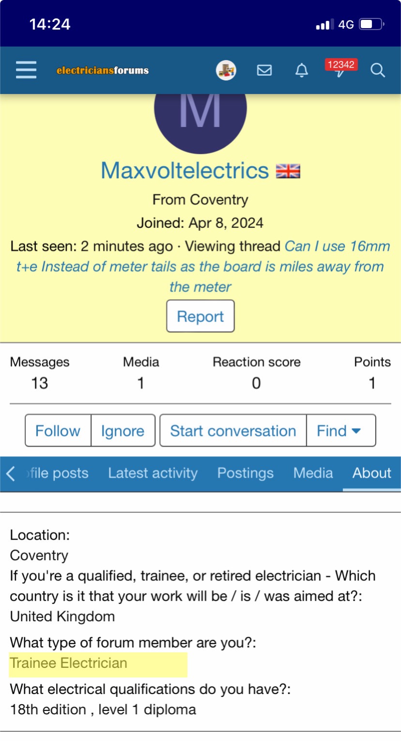

Not sure what you mean I’m still learning but i do have 3years experience but mainly in domestic work rewires kitchen extensions etc
Just meant here….
I’ve highlighted where it says Trainee.
I just mention it, because sometimes we get first year apprentices attempting something way past their competency level.
If that’s not the case, then sorry if it sounds like I’m having a dig…. Im really not.
Shouldn't be a problem but check your volt drop.
Just meant here….
Oh I get you and no it wasn't taken that way so no drama as I’m not fully why didn’t want to put that I was
