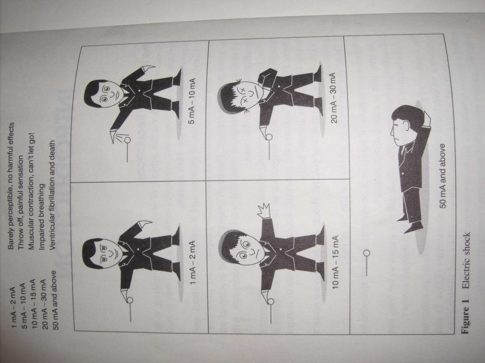

Hi all,
I am just finishing my Level 3 City and Guilds level 3.
I am going to replace an old re-wire-able fuse type CCU with a dual RCD CCU. When replacing a CCU in the past i have just removed the main head fuse to disconnect the supply going to the CCU.
But someone at my collage has mentioned that you are supposed to contact the supplier and they will send someone out to do it? This seems a bit pointless as they will then have to re-connect after i have finished?
Can someone clarify?
Also if i can just remove the main head fuse, where would i get the wire which goes in to stop people removing the fuse? And what is it called?
Thanks

i used the pic as an example the meter of the house in the pic was changed in november 2010 a full write up is on another thread VIR a ticking time bomb hence the reason for my comments
Right so its not the amps that kill then, what is it?
I suppose a mixture of environment, volts and amps!
As you said, it's not just the current - you can survive a very high current shock if the duration is short enough. Technically, a specified figure of energy (in joules) delivered in a specified period of time will produce consistent mortality. Frequency will also have an effect.
