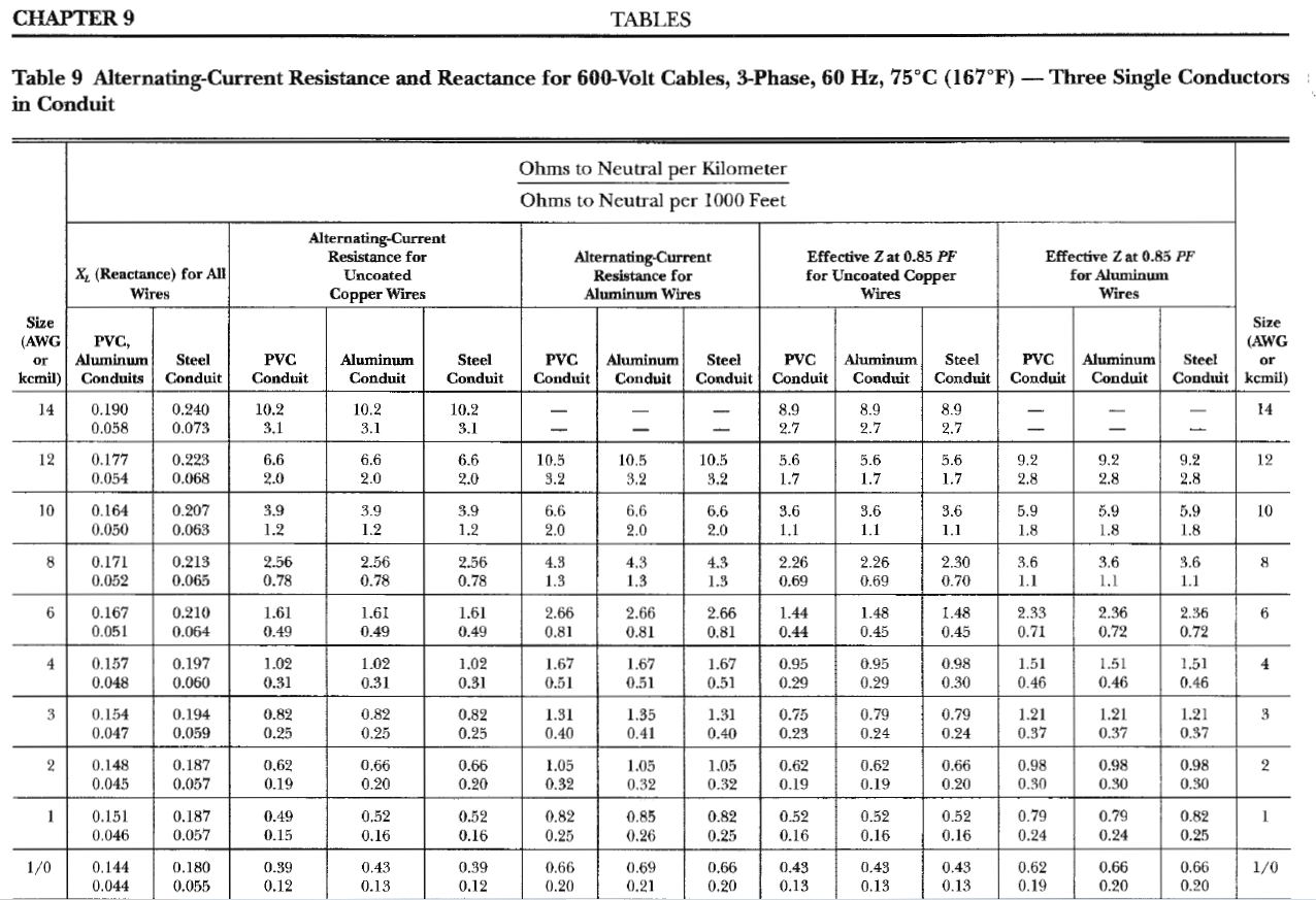

Ok, say you've got a lighting run with the last fixture being 1,280 meters away. 1,800 watts per phase 3 phase, 277/480Y volts though in this example we can use 230/400Y for the ease of discussion.
My question is- what size wire do I run for each phase and earth? What disconnection time do I use? Do I use a Type B, C or D breaker? What should my max R1+R2 come out to be?

Looking at details it says 68F = 20C which is room temperature around my part of the world.
Also probably they are DC, starts to become a source of error for large conductors as skin effect kicks in.
I should know about this link! ????
Anyway, do you know of a table taking skin effect into account? For a while I've desperatly been searching for an AC resistance at 30*C.
At AC power frequencies the skin depth in copper is about 9mm, so any conductor that is less than around 20mm diameter it has quite a small effect. Somewhere there will be equations to allow its computation for different conductors but most folks in engineering take the easy route of getting a feel for when you can ignore something, and ignoring it.
For example it is unlikely you will know any AC system parameter to better than 5% uncertainty, let alone 1%, so once effects get down to the 5%-ish region they can be often ignored for most purposes.
The temperature coefficient for copper is around 0.00393 so each 10C increase in temperature has a 3.93% increase in resistance. Which is about 4%. Which is why the UK regs have a 0.8 factor for going from measured at 20C to Zs value working at 70C.
Yes, our regs do have detailed formulae for non-standard cases such as measurement very cold/hot and/or operation at unusually high temperatures, but that vast majority of industrial cases are just like commercial and domestic in the 20C test & 70C assumed max operation is perfectly applicable.
In terms of generic AC values we have tables in the regulations with the values to assume. For example this if for single cables in various configurations giving both the DC and AC "resistance" values (more correctly the voltage drop due to cable impedance):
If you look closely at that table you can see where the skin effect comes in by comparing the DC volt drop with the resistive term 'r' in column 5, but more generally it is the total impedance 'z' that would be used for volt drop if dominated by the cable.
Though close to a transformer, etc, where reactance is also a big factor you would be separately adding the r & x terms and finally computing z = sqrt(r^2 + x^2) to get your impedance.
Alright, because in all honesty I'm trying to get these values down to 30*C:
Just a tad bigger than I'm used to thinking about.... ?
To be fair it is a lot bigger than I ever have to deal with.
Also as you get to such large conductors there are good reasons to consider parallel sets instead. Not only are they a bit easier to wrangle, they have a higher current rating for the same overall CSA as cooling is usually better. However, you do have to consider cycling the sets to keep current flow, etc, balanced and you also need to look carefully about the OCPD implications for a fault half-way along one of the set, etc.
