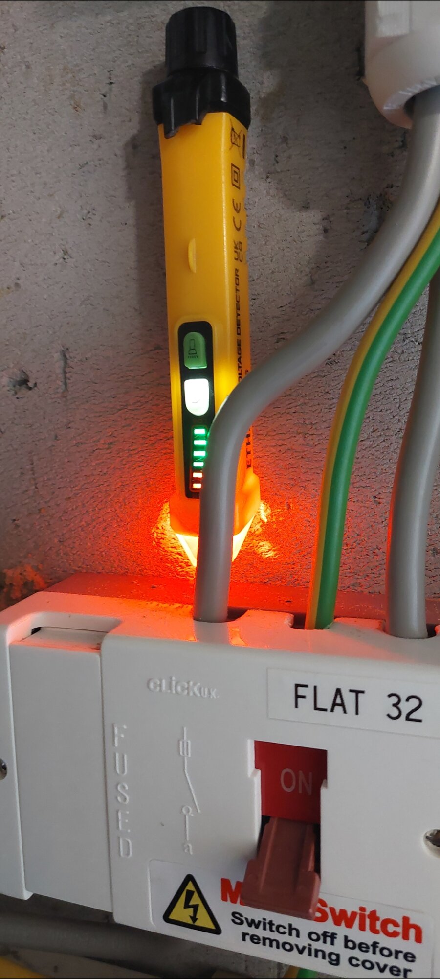

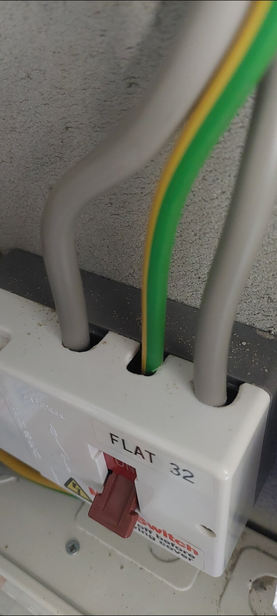

How would others code the switch fuse not meeting IP4X on the top surface?
The live terminals are very close to the top edge
[ElectriciansForums.net] Click UK switch fuse
These kind of nibble outs have always naff and normally nearly always leave a gap around the cable entry. Most sparks will squidge a bunch of mastic around the gaps but it still looks rubbish
It's in a communal cupboard what if someone put there car keys there while checking the meter? Is silicon conductive before it dries.
ip4x is a 1mm piece of wire,ip2x refers to a bs finger
Or decided to take their metal knitting needles in there. I was trying to make a sensible risk assessment.
Silicone is not conductive snd - in any case - why touch it while it’s wet?
But we are now talking about resolution of the issue. I thought you were doing an EICR?
