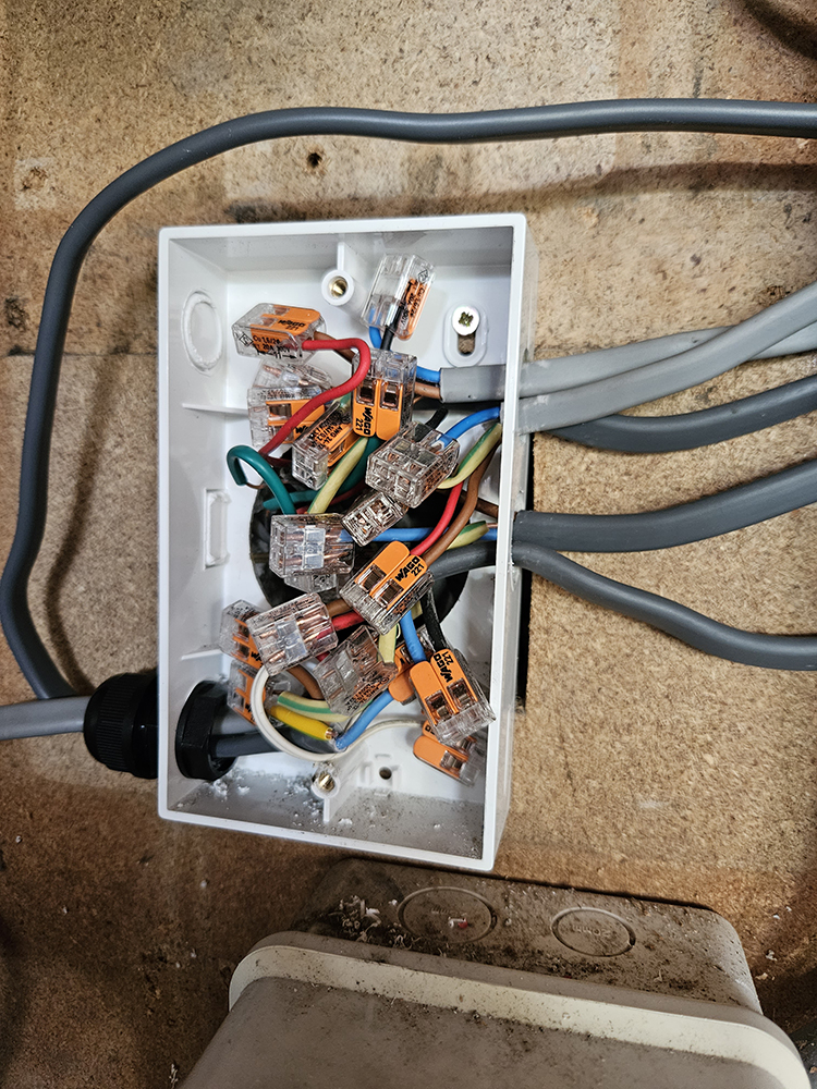

Hi all! I'm not a spark but know enough to be able to install off grid solar etc. I've just purchased a new house and have noticed the consumer unit was extended at some point:
[ElectriciansForums.net] Consumer unit extension wiring
The additional unit is from the kitchen as they had a new kitchen fitted. My concerns are with the quality of the work. No glands are used and all wiring enters the side, the cables also have sheathing cut short so the wires are exposed. I'd have thought some simple chaffing could expose a wire and short the consumer unit:
Due to these concerns I opened up the box to take a look at the method used to extend the wires:
I have a few questions here... why are glands not used? Is it ok not to use a DIN rail and simply extend all circuits with lever terminals? If so, would splice connectors 221-2411 not be more suitable? If the cables aren't long enough to reach a DIN rail, would it be best to use a Wiska Consumer Unit Relocator for any circuits that do have a wire long enough, and then extend the others?
I'm assuming this is legal, but sloppy work.
Unfortunately the cables aren't long enough to allow the Wago junction box to be used correctly, what's the best way to resolve this, if any?
Without seeing it for myself this is a bit of a guess, but I'd probably grab a 20mm holesaw and make three or four holes holes is the back of the top of the Wago XL box near the top, mark everything with a Sharpie and then feed the short original wires through the back of the box, resulting in the short wires being nearer the top, and the box being mounted lower down.
When done you should fit cable ties so no one can easily unclip the front.
EDIT you may have to flip 180 degrees so the wago's are at the bottom, and the new cables enter at the top
Out of interest, if I ever upgraded to rcbo's, I'm assuming these are all single pole aside from the 'sockets first floor' because I've found this is actually incorrectly labeled and it's actually sockets for both floors with two cables entering the one mcb. Therefore it'd require a double pole rcbo?
...or is it simply wired like that as its a ring and not a radial, therefore still a single pole rcbo

I'll be able to sign off domestic installs imminently. Seeing the level of workmanship drove me to study the level 3 etc. The consumer unit is now all sorted and the junction box is completely removed, alls the original installer had to do was move the consumer unit down a foot to make the original wiring long enough 🤷🏻‍♂️
With the removal of the unrequired joins/extensions, and with rcbos and an spd introduced alongside properly 'torqued' connections I'm a lot more comfortable with the installation.
