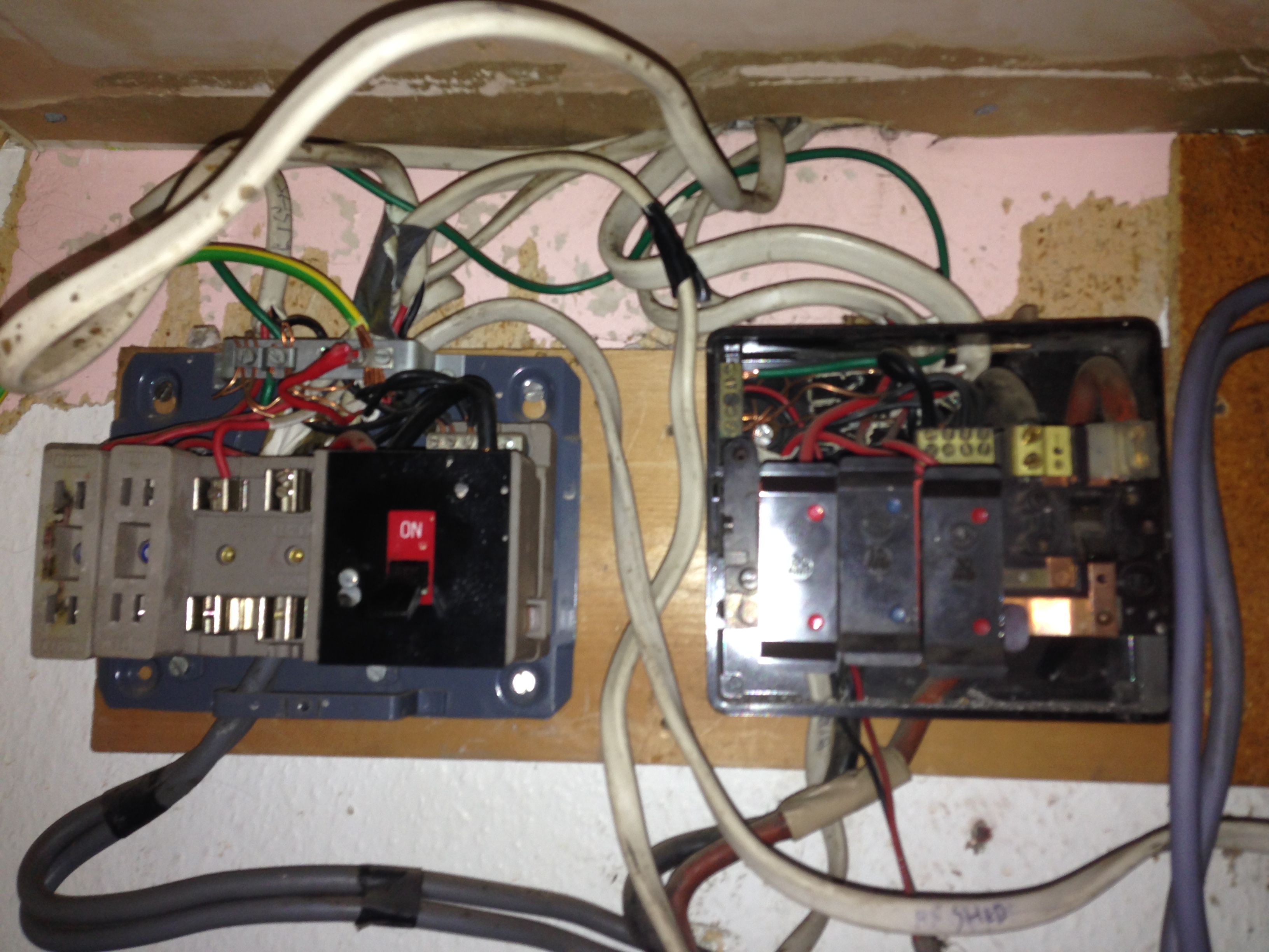

I changed this to a single CU as well thought it best..Customer kept getting electric shocks as well...before not after!

Can anyone give me a list of things from an EICR that might mean that your consumer unit might need replacing
? is this a serious question? if so please come back and explain why you asked this and maybe we can try to assist you, that said, I am concerned you are in one of two camps. 1, you want to justify replacing a DB, or 2, you have been told yours needs replacing and you are not sure.
I tend to agree with the above posts, however I think I remember that you are early on in your career, so may be attempting to learn, the assessment for a CU change is more than an EICR result and to not realise this indicates a lack of awareness.
However I did go through the EICR observations for distribution boards and came up with the following, if the observation was coded for danger would the consumer unit need changing?
